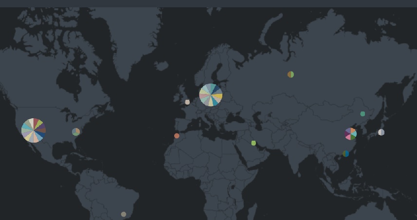

If I look at who is trying to access blocked port on my net, it looks like this the last 60 min:
I do use my Splunk for Mikrotik to get this map: http://forum.mikrotik.com/t/tool-using-splunk-to-analyse-mikrotik-logs-3-3-graphing-everything/121810/1
So here you see that EU and USA has more hits than Asia.
Why?
There are lots of services (that are not illegal) that do scans you all the time. Like https://www.shodan.io/
They are looking for internet of things devices. Our work net is hammered hard by them and other.
What can you do? Block country that you know that has no interest of your data is a good start.
It will remove lots of hack attempt, but you will still be scanned.
What I have done, is not the best for all, but works perfect for me.
If an IP tries to access one block port on my net, I add this IP to an access list and block this IP for 24 hour.
Them map above has less hits than it would be without my access list.
The access list does have around 1500 IP in i all time, sometime up to 2500 IPs
