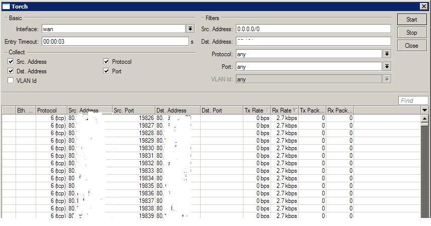

block unknown port number packet
Please note the attached picture
tourch wan interface
protocol = tcp
source address = known
source port number = known
destination address = known
destination port number = unknown
how can block this packet?
this traffic generate with hping3 command.
Unfortunately you decided to blank out essentially all the relevant information in that screen shot.
So you say the source IP, protocol, and port are known, as is the destination IP. Assuming the source IP is 1.1.1.1, the source protocol is TCP, the source port is 1 and the destination IP is 1.1.1.2, simply write a firewall filter rule the specifies the known parts and has an action of drop. Also assuming that the packet is going through the router rather than to the router (the destination IP is not an IP address assigned to a router interface after destination NAT) you would use the forward chain, otherwise use the input chain:
add chain=forward src-address=1.1.1.1 protocol=tcp src-port=1 dst-address=1.1.1.2 action=drop

please run this command in linux machine
hping2 www.wxample.com -d 654000 --faster
now block generated traffic by several machine on the different places.
its ddos.
