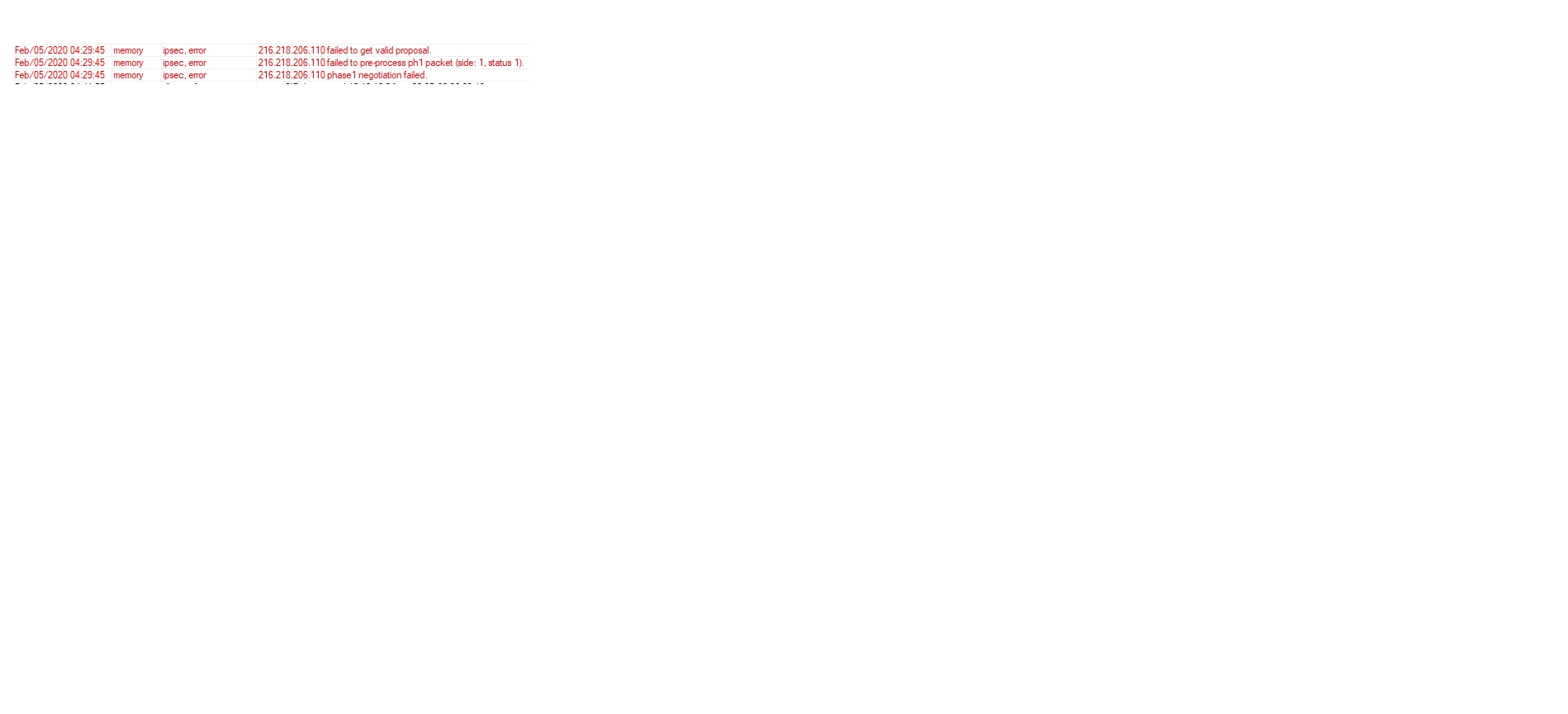

How good is it to block a specific external IP address? I did the following but it does not work because access attempts are repeated every night!

At first I had an entry on -Input, but that didn’t help. Red log messages appeared unchanged. If the rule works correctly then the log section shows these red statements or not?
Log entries and firewall rules have only slight correlation. Assuming that firewall filter rules work as entered (could be that it’s not as they were meant to but that’s another problem) and I’ve not seen any report in contrary, then log entries only state that something doesn’t work. And if it doesn’t work, then it’s probably per design.
One obvious conceptual error is to have block rule with “log=yes” and then get concerned because there are many log entries about that block rule. Which is expected because just because there’s a block rule it doesn’t make people stop trying to get in. And loging blocked connection attempts is useless after initial debugging is finished.
This is not exactly your case (logs are about IPsec), but same principle applies: you blocked connections and IPsec complains it can’t establish connection. So you need to find out why RB tries to establish IPsec connections to the blocked subnet.
Interesting as I get these logging entries as well at around 3:00 AM, on a daily base. Does anyone have a clue who is behind these automated attempts?
Yes, these connection attempts take place regularly every night! In my case L2tp ipsec is used. Special logging is not turned on but red notifications are displayed. This IP address has been displayed for a very long time on some 30 mikrotik machines that use ipsec vpn. If tunnel mode is used and explicitly allowed IPs are displayed, then these red messages will not show. They appear when not in tunnel mode and use L2tp ipsec with connection from any address.
Watched web ip location - Presented by United States of America, Calofornia, Fremont, ISP - Hurricane Electric LLC
There’s probably someone doing bad things …
If there is a rule input chain where this subnet is blocked, maybe it doesn’t make sense to worry?
If you are seeing the IP in the IPSEC LOG then it is making it through your firewall. If the firewall rule was working you would not see that IP in the IPSEC log

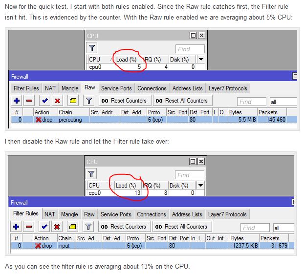

There isn’t a simple answer to the question about using raw vs. “normal” firewall to drop packets.
When using raw to drop, each and every packet will be examined. However check is fairly simple.
When using “normal” firewall to drop, all the usual “accounting” will already be done. With usual SOHO type of setup this means that connection tracking machinery already did its job and this is single most resource-expensive operation of a firewall. However this makes possible to take a few shortcuts, such as fast-tracking, meaning that usually only a small fraction of packets actually get examined.
Then the decission about which method if dropping packets depends on overall configuration of a device and mix of traffic passing through.
If the offending packets occur rarely (which is most of times with usual port scanners), then the additional processing overhead caused by raw filter is relatively high for little effect.
If, OTOH, rate if offending packets is high (which is usually case during a typical DDOS), then the only way to sustain the episode is to use raw firewall processing as high incoming rate of (according to connection tracking state) invalid or new packets can easily overload firewall.
