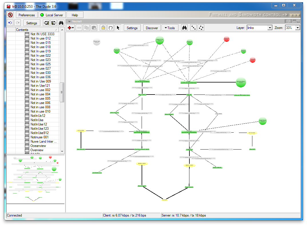

we have two router (RB1xxx) connecting via fiber cables ( 1G) ports to the internet.
Each router is configured as a train ( A & B main / backup)
The routers are connected via a single ip (local) 41.168.6.130/32 remote 41.168.6.129

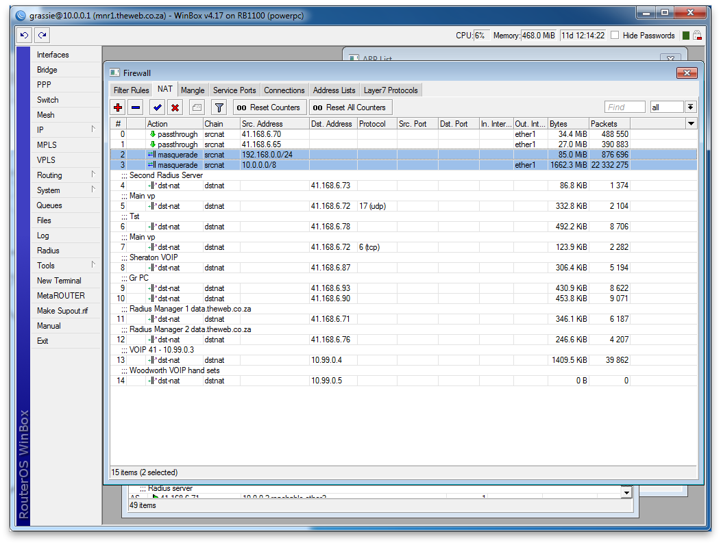

Currently the masquerade is set to masquerade only 10.0.0.0/8. ( coming from ethernet 2)
Some how the ip 41.168.6.130 get blacklisted which means that the the data get masqueraded to ip 41.168.6.130 and not as ip 41.168.6.68
6 chain=srcnat action=masquerade src-address=10.0.0.0/8 src-address-list=!41.168.6.65 out-interface=ether1
Is there any way I can configure the router to only masquerade data from ethernet 2 to ethernet 1 as ip 41.168.6.68 and not to 41.168.6.130?
Attached is the lay out of this site.
Don’t use masquerade. Change the action of that rule to src-nat and manually specify your to-address. “masquerade” is the same as src-nat but automagically picks the to-address, which in your case is the wrong address. Once you manually pick it you have full control over what traffic gets NATed to.
Search the wiki and forums for approaches to preventing machines from sending out mass email. It’s fairly complex a problem and had been covered elsewhere already.

The dude view is 100% the lay out
I am also in doubt, because that is quite a mess and hard to read.
Replace your NAT rules that have an action of “masquerade” (which should only be used with interface that receive their IP via DHCP or a PPP process) to have an action of “src-nat”, manually specifying the IP address the router should use to replace the source address with via the “to-address” parameter.
I don't know why it cam out the way it did this is all I have. Two masquerade rules.
The two rules are:
This is input from ethernet port 4
add action=masquerade chain=srcnat comment="" disabled=no src-address=
192.168.0.0/24
This is from ethernet port 2
add action=masquerade chain=srcnat comment="" disabled=no out-interface=
ether1 src-address=10.0.0.0/8 src-address-list=!41.168.6.65
Both leaving via ethernet 1
