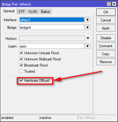

If ports on default bridge are hw offloaded, bridge filtering won’t work. Disable hw offload for the ports you want to enable filtering.
Why not secure the device itself?
Remove the hardware offload of the desired bridgeports /ether2 and ether4/ !
If you want to isolate and on second level Bridgeport 2 and 4 - use a split horizon with the same values ​​on the respective ports!
