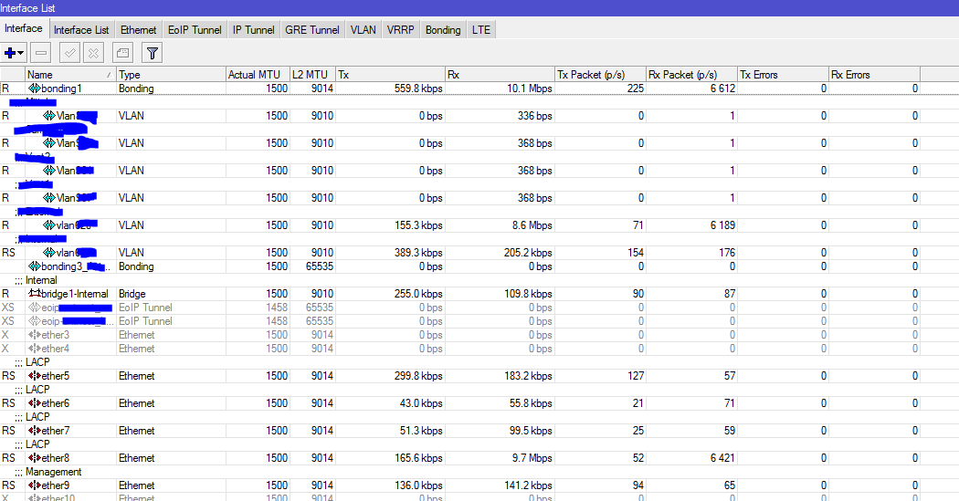

We have recently experienced a situation where 4x 1gb nics in a 802.3ad bonded setup to a cisco backend with vlans defined on top of bonded interface results in 3-4% packet loss.
The setup is a single LACP trunk and our vlans defined on the Mikrotik x86 6.38.3.

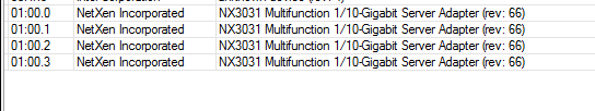

Tried to test the theory with these cards and tried a nx3031 HP card. Unfortunately this is not supported, picks up within the resources/pci section but no driver as the ports are not available…

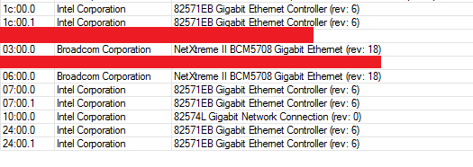

In this machine we had 4x dual port cards which was picked up as Intel 82571EB cards and these were the cards in use.

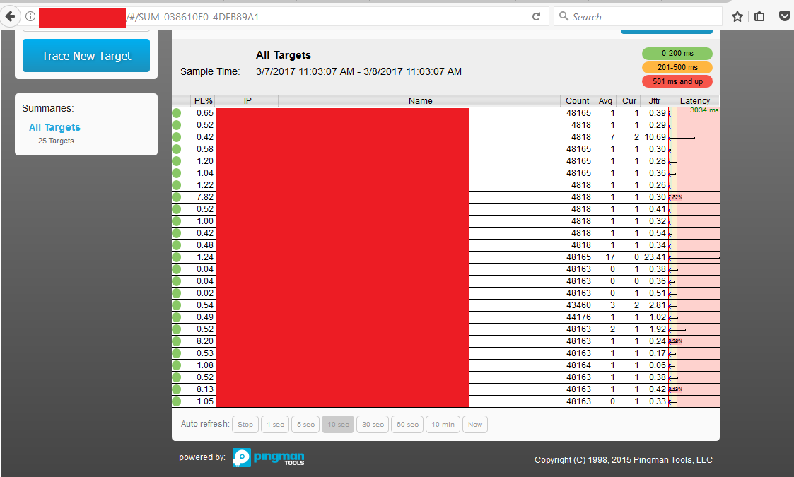

We finally found out that the system also got progressively worse as more traffic flowed through it with loss being 0-1% with minimum traffic. (I’d say up to the 40-50M mark) after that it increased to the 3-4% mark anything above that threshold with some hosts going as high as 11%.

This lead me to try bonding only the two onboard cards namely the BCM5708 cards and all the issues went away!!! It seems the problem is indeed as you suspected the drivers used for the Intel 82571EB cards!!!
Here is a snip of the cards in the system at this point in time. (I have swopped the one dual port 82571EB card with a single port 82574L to see if its maybe an issue with certain revisions??? , but have yet to test)
