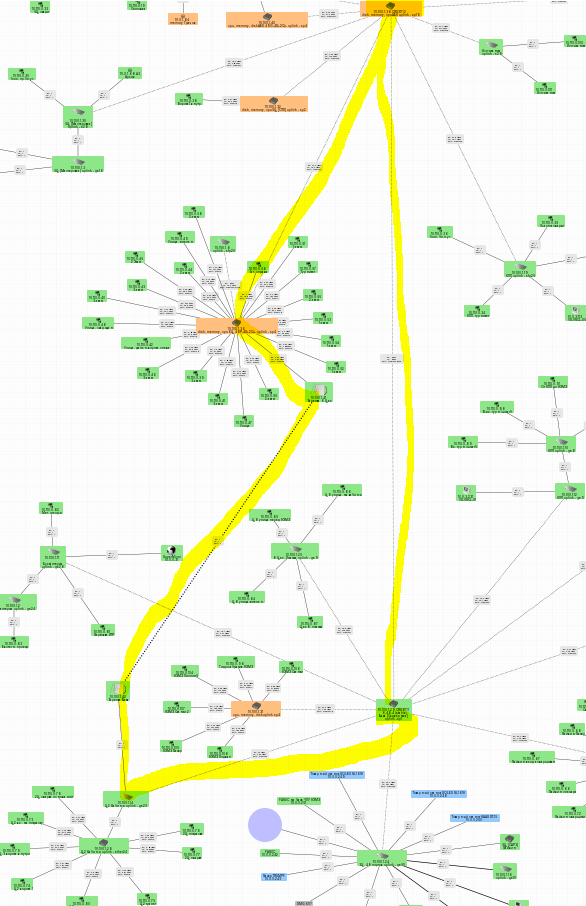

My network in attachment.
Right link - link between two CRS 317.
Left - spare channel with other switches.

I’m not an expert but this topology seems to me a prime candidate for RSTP … with the microwave link having the high path cost so it’ll only be used if any of lower path-cost links fail.
Everything pushes me to use STP.
I’ll try
