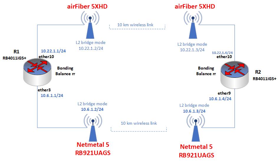

I have problem with winbox access and web interface while bonding is activated on both ends.
I have the following scenario shown on the picture, my network is OSPF routed and I have bonding on both ends .
When I disable bonding I get access on 10.6.1.2 and 10.22.1.2 also on 10.6.3 and 10.22.13 devices . Winbox and Web interface are ok without bonding.
I read the documents and notice somewhere that VLAN tagging needs to be added on bonding interfaces , separate VLAN for management. If someone has experience in this sphere please help :slight_smile:
I am sorry for large pictures
Network topology

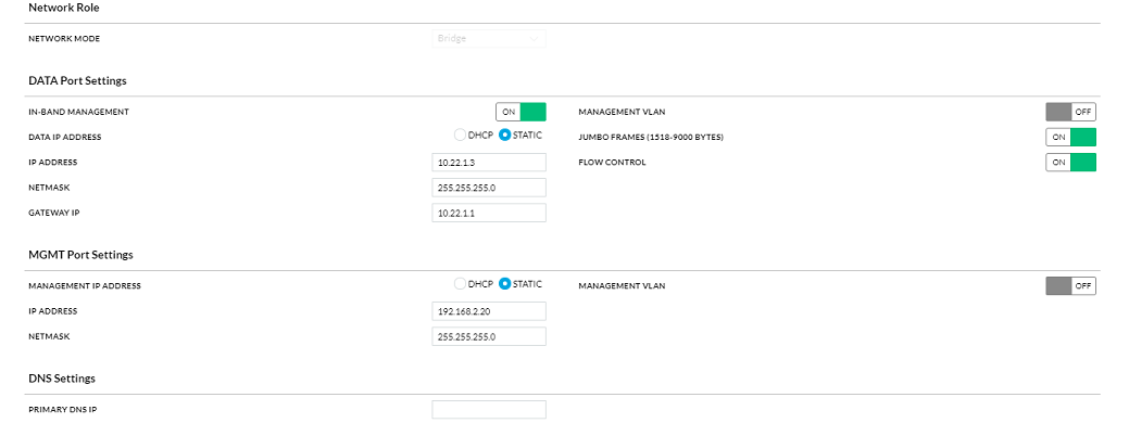

AirFiber 5XHD info 10.22.1.2
AirFiber 5XHD info 10.22.1.3

See https://wiki.mikrotik.com/wiki/Manual:Layer2_misconfiguration#Bonding_between_Wireless_links
As AF5XHDs have separate management ports the more correct way would be to add additional cables between the 4011s and radios, then use those interfaces for management.
@tdw: Yes I will read now .
I know AirFiber has separate management port, But I don’t want to add additional 50 meters cable to the router 4011 .
