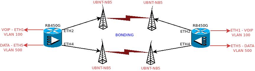

I want to realize a network like in the attach.
I want to priorize voip vlan and if is possible use or how to use vlan feature of RB450G switch chip.
Bonding interface is ok , and vlan work over it.

As I can see, you already have VLANs on different LAN cables coming out from switch probably. Simple add a bridge on both RB450s with three ports: bonding, eth1 and eth5. That should give you L2 connectivity throughout the whole network needed for passing VLANs.
As for bonding monitoring, select on bonding interface, monitoring=arp.

Now all bonding ap and lan have an ip …192.168.100.1/29 bonding rb-A …100.2 NB1 100.3 NB2 100.6 bonding rb-B 100.4 NB3 100.5 NB4
speed is strange (with ubnt internal speedtest for the 2 link is similar and around 80 mbps 1 direction 1 link) with ROS bandwidth testt from rb-A to rb-B I have around 80mbps 1 direction if I switch off 1 link I loose only 3-4 mbps.
The bonding interface is in rr mode and arp for fail over , from rb-A if I ping a NB on the other side I have a response like
0ms
timeout
1ms
timeout
0ms
timeout
without one link I have always 0 - 1 ms without timeout
NB are in AP-WDS → WDS station
Any idea, about this strange thing?
