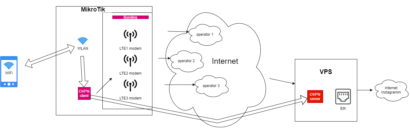

Goal: organize sufficient bandwidth and redundant (if possible) channel for conducting live broadcast to the social network (Instagram). We will leave the problems of logging into someone else’s IGTV account outside the scope of the case. The stream will be standard IG media from the phone.
I planned a scheme like this:
We will skip fine settings. I understand how this can be done through the balancing and packet marking in PREROUTING. I just wanted to shift this task to the existing standard “Interface - Bonding” function.
I do not understand why Mikrotik does not consider the LTE interface to be identical to Eth or Wlan, if it is also assigned a MAC, and you can interact with it at the L2 OSI level. Obviously, on the side of telecom operators, other levels arise, perhaps this will create collisions, but on the side of Mikrotik, LTE is also an interface.
By the way, in the functional Bonding I can even include created by ovpn-out interfaces! But LTE can’t …

Wait here, taking a step back:
You use a mobile phone (= LTE device , soon maybe even 5G) and go over Wifi to an AP and to LTE modems? Sounds like not the easiest one
Why not go directly from phone into internet? (you can add VPN onto the phone)
Current Mobile phones (mid/high end smart phones) have CAT10 or more inside (up to CAt18), these are beasts in terms of achieving high throughput, low latency …
You can even have dual sim, dual standby etc..
I don’t know what LTE modems you connect to your router, but many are CAT4 (lousy), CAT 6 (so-so), and only few are higher CAT than 6.
Achieving the performance of a modern mobile phone which has 3 or more carrier aggregation is quit difficult with standard LTE modems for routers…
I would give it a try directly with the phone rather than try to do what you planned…
