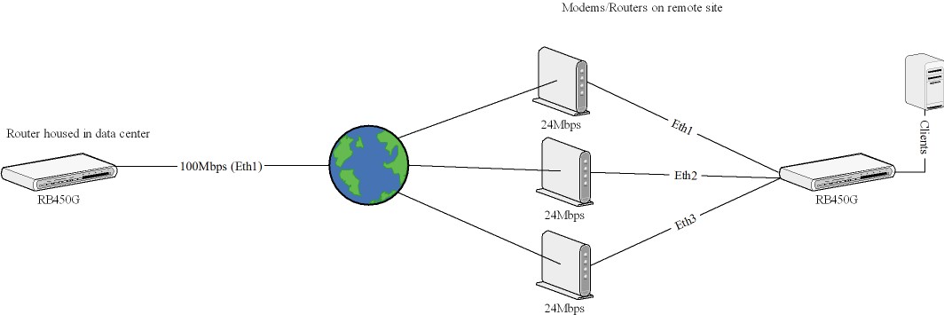

Hi all
I’m back to square one! I tried to bond 2 EoIP tunnels together to increase bandwidth to one of our sites but it proved unstable. Using the below diagram is there any other way to bond 3 ADSL lines together (VPN?) without using EoIP? Thanks all. Jon
My suggestion would be to get a provider that can give you MLPPP, your current provider may already be able to do so. That’s a protocol specifically made for bonding several PPP connections into one virtual circuit, with the two ends taking care of all possible re-ordering issues.
