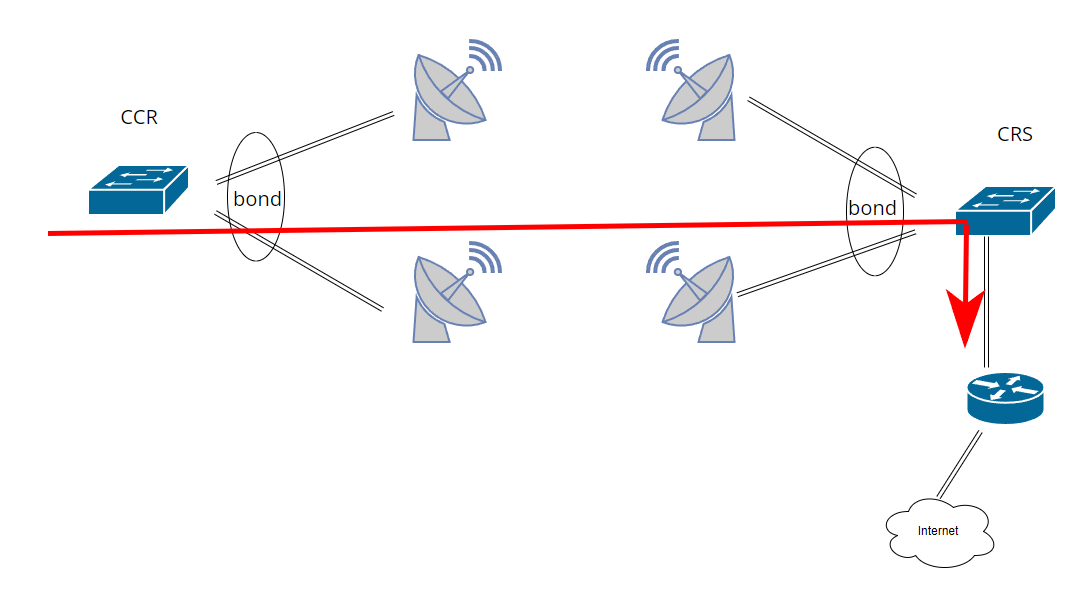

I’m trying to setup a bonding over 2 wireless links. It works fine but with some caveats…
On one side I have CRS112-8G-4S and on the other side CCR1036-12G-4S.
CCR1036-12G-4S: using bridge, with vlan filtering (this device has very high performance for bridging)
CRS112-8G-4S: here I have to use switch because it’s a lower device and the only way to achive +500Mbps is using switch
The problem is I cannot manage the bond interface in a same way that the switch is working.
On CCR1036 I just added bond interface to the bridge, allowed the tagged vlan I need and it pass very well.
On CRS112 I need to pass the tagged vlan directly to a phisical port. I know I can setup a bridge to do that, but the performance will be very bad.
I need to pass like 800Mbps (2 500Mbps links) switching vlans (not routing).
I would like to know if I’m missing something or my diagnostic is good and the only way to fix this is switching the CRS112 to a CCR1036 (or similar device) with high performance on bridge setup.
Here’s a schematic. The red line shows the flow of ethernet packets I need.
Any help will be apreciated.
