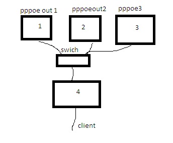

i do recive internet using pppoe
i want to make three router each one with account and make bonding in 4th
any comment
You can’t bond unless the other side of the PPPoE circuits also is bonded. Is it?
i blive that other side of the PPPoE circuits becouse i hear that some people do bonding and thay has the same suport
Then they either don’t know what ‘bonding’ means or you don’t know what ‘bonding’ means.
Or your provider doesn’t care what you put on a link, in which case you just proceed and bond like the manual tells you to and hope like hell they never complain and stuff doesn’t break.
http://wiki.mikrotik.com/wiki/Manual:Interface/Bonding
Of course you won’t be able to run any modes that negotiate settings because the other side won’t be running the same protocols.
Have you called your provider to ask if they support bonding?

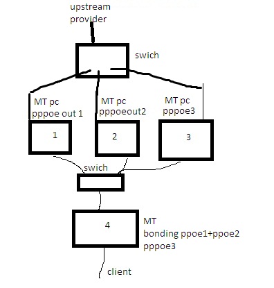

know that you do know what you talke about but i think my provider dont know that we could use bonding or my friend find a way to turn arownd and make bonding work
i talk about turn arrownd cuz my friend use for each account pc
as i had draw before
each pc for each account= my provider dont care and my friend not so smart
my provider care and close bonding and my friend so smart to make bonding work
it more clear for what happen i hope
does any one see something like that
don’t mix up bonding and load balancing
why you think it load balancing i do use pcc for load balancing
each ppoe limit with 512k and iam talk about 512k+512k+512k= 1.5m
i wantto make bonding not loadbalance
will your ISP configure bonding on their devices for you? don’t think so
sure not my friend had do it
i dont know configurtion i just now waht i drwa in pic
please ask your friend about his setup. we all are waiting for the miracle…
his s bad one hahaha sure when i have i will post it
i hope to be real miracle not bad explain from me
lolol that will be bad
thx
