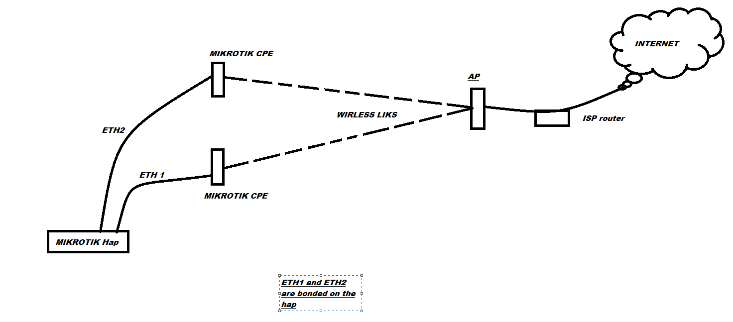

hi all
I have a setup I want to do where I bond 2 CPE’s to one AP is this possible and if so how would I go abode doing it.
I was thinking of using the interface bonding in mikrotik.
id like to increase the speed.
in my mind this would increase download but not upload that much but that’s ok with me
I’ll attach a bad drawing of wat my idea is.

bonding is done for bridge. income from taking from same device 2 routes=0.
in your language/drawing - 2x AP 2x CPE and then wiki ..
from your diagram it’s not a bonding setup, but a load balancing one.
With bonding you will increase the capacity of a single Ethernet line by combining more than one interface from one device with the same interfaces on the main router.
In your case you need to load balance the traffic from the 2 CPEs into the hAP; this is not going to be the sum of ETH1+ETH2, but traffic gets spread across ETH1 and ETH2 based on concurrent streams generated by different users on hAP lan.
You can read more about this subject here: https://wiki.mikrotik.com/wiki/Manual:PCC
Armando

In term of port aggregation the use case it’s different from what you are looking for.
Let’s say your CPE does have 2 ETHs=100mbits but your radio link is capable of 300mbits, then you can limit this bottleneck by bonding both ETH1+ETH2 at CPE and connecting 2 cables to your router you can get almost 200mbits capacity on WAN and keep up with your radio link.
On the case that you are looking for, other than load balancing, you can see just for study purpose this lecture about VLAN bonding where you can aggregate traffic from different devices in your network. But this will imply adding switches and extra things, which I don’t think is what you are interested into.
It’s just for reading and learning.
https://wiki.mikrotik.com/wiki/Manual:CRS3xx_VLANs_with_Bonds
Armando.
Also this link could be useful to see what bonding is about and some use case scenario to get some idea based on your equipment.
https://wiki.mikrotik.com/wiki/Manual:Interface/Bonding
As said in the article it’s a matter of load balancing and failover setup that you will get.
You can try to check on implementing mangle rules in your hAP to manage such load balancing with your current setup, otherwise you will need to manage this with the use of some switch, like in the shown cases.
Armando
