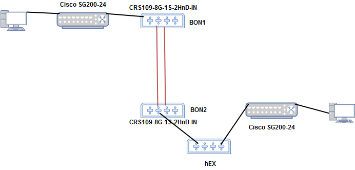

I’m trying to speed up WiFi link for users on second site.
Current design is:
Since I have spare 2 x Dynadish and 2 x CRS I wanted to create bonding of these two links.

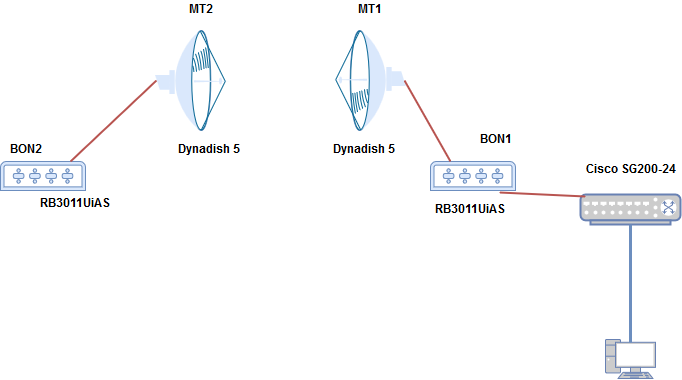

So desired design is:
I have tested desired design but I get worse performance.
Can anyone give me suggestion or resolution where I’m doing wrong?

So I can confirm that CPU is main problem here. We are going to buy new switch router with stronger CPU. Any advice? RouterBOARD 3011UiAS-RM ?
you must test final client(pc) to client(pc), testing is cpu hungry and running it on the same mikrotik device will not show real link results since cpu is used for generating traffic and the remaining for routing it.
I did in first run. It was really slow. We have ordered new RouterBOARD 3011UiAS-RM and will try with them.
You have to remember that Bonding interfaces is also CPU bound
Even with new devices RB3011UiAS same problem.
Have you tried leaving the rb3011’s and bond interfaces in place and only tried it with a single link in the bond?
This will tell you if it’s an issue with the Dynadishes or the devices doing the bonding?
If things improve with one dynadish then we can look at that. If they don’t then we need to look at the bonding.
How are you testing? Can you post some results showing actual performance figures?
As was pointed out earlier you need to test with PC’s NOT the bandwidth testing tool.

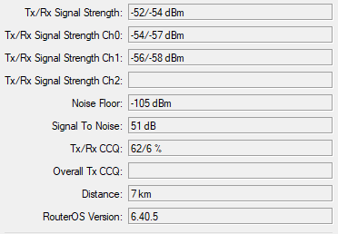

CCQ is interesting:
One thing I noticed as I observed CCQ value is that initially it was 70% and gradually ove one hour it went to 6%.

Quick thoughts, I’d say you could turn down the TX power level’s a bit to bring RX into the -60’s.
Have you checked to ensure there is enough physical separation between the dynadishs?
Have you checked they are not on the same or very close channels (I.e Overlapping).
The poor CCQ is the problem. If you one run the link with one pair of dynadishes what is the CCQ like normally?
Assuming you have a clear path between sites it really sounds like the dishes are interfering with each other.
Assuming you are on different non overlapping channels and the CCQ only goes low when you use both pairs it sounds like you may need to add a bit more physical separation between the dishes.

Well with a receive level in the -50’s you need to turn back the tx a little, They are screaming at eachother .
Which one? I’m still waiting for guys that installed this link to come and check this problem.
I see on all four Dynadishes Tx Power Mode: default.
to answer your question any unit with an RX in the -50’s then you need to turn down the tx power of the one it’s talking to,
Chance are you will need to turn down the tx power on them all
The company that installed two links tested them yesterday. We did turn down little bit power, but in the end problem with bonding was still there.
Then we went to secondary site and tested connection from clients to internet and we could clearly see that bonding is actually working as it should.
In first tests I did not test connectivity to internet but only to servers on primary site. Doing this test gave us clear picture bonding is working (we could see traffic being split on two ports).
The problem is that traffic to LAN on primary side is interrupted in some way that we need to find out how and why with company that controls DELL SonicWall UTM.
Thanks for all responses! I will report back if we get chance to check SonicWall logs.
