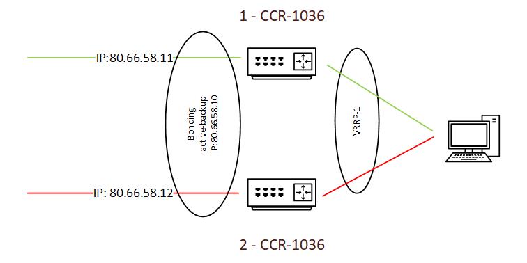

Hi
I would like to set up a setup like the one shown in the picture. The VRRP client side is already running. But I can’t get any further on the WAN side. I have no idea right now. Can someone give me a tip? If WAN is green away he should switch to red. However, it must be accessible on both lines under IP:80.66.58.10. on a router that works but how is it with 2?
thank you
Larsen
you’ll need vrrp with load-balancing (setup in a failover configuration) bundled together with a custom script.
