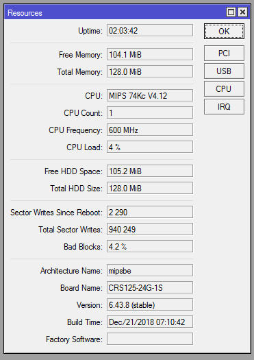

I formatted the NAND (Flash Memory) and re-loaded RouterOS. After less than a week I started to notice some slowdown on the internet performance. This seems to indicate the start of the potential corruption of the OS where the boot loop with start. I rebooted the router to check to see if the OS was OK, and to fix the performance issue. Luckily the boot loop did not occur. I did however notice that the bad blocks on my flash has increased from 4% to 4.2% in less that a week. Could this be the culprit to my issues? See the attached screen cap.
Any insight would be appreciated.

I was not thinking, and forgot to check the console output when it was boot looping. I think I just wanted to get it back up. I will try and remember next time. One odd thing to note, is that after the netinstall I checked the resources, and bad blocks are at 0.0%. Before it crashed bad blocks were at 6.0%. I would figure once a block is marked bad it would stay that way.
Any insight into what is going on would really be appreciated. I would like to know if this is hardware/software or configuration.
