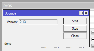

Then i update from SSH SwOS to newest 2.13, same result, there was no beep during start up.
