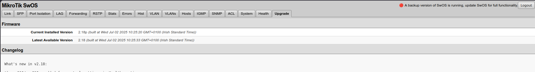

What I found is that CRS310-8G+2S+IN does boot from ROS 7.22.2 to SwOS v2.18 but the only working ports are SFP+ ones… I managed to login via the SFP+ and found SwOS version with letter p appended:
Upgrading to regular 2.18 didn’t fix the issue. Looks like in this combination ethernet ports are not working.
