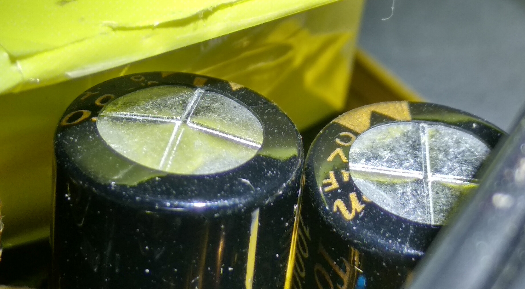

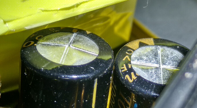

Look at replacing the power supply?
Thank you, one more experienced person I chatted with before, said the power supply failure is the most frequent problem with CCRs, but surprisingly official support never ever gave such clue. PSUs seem to be $26 here in the US, will try to order it and will report on results.
With high probability it is - mine behaves just like on this video - the voltage drops to zero just at the moment it decides to boot again - https://www.youtube.com/watch?v=Ylh_Wsd1gTc and the left capacitor belly is bumped:
I wasted so much time with no relevant clue in this direction from support…
Ugh, yeah, let us know how it goes.
That was indeed that capacitor. Too bad the PSU is not smart (unlike Dell’s has which in contrast has logic and firmware updates and can tell if it has issues), looks like with new power supply it’s stable again.
Thank you for the spot-on advice!
