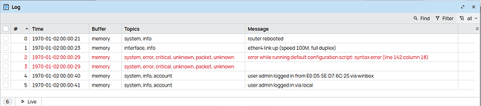

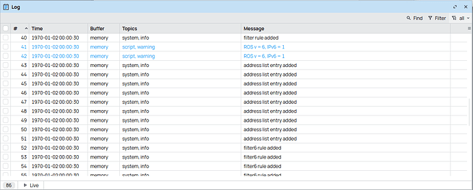

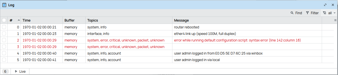

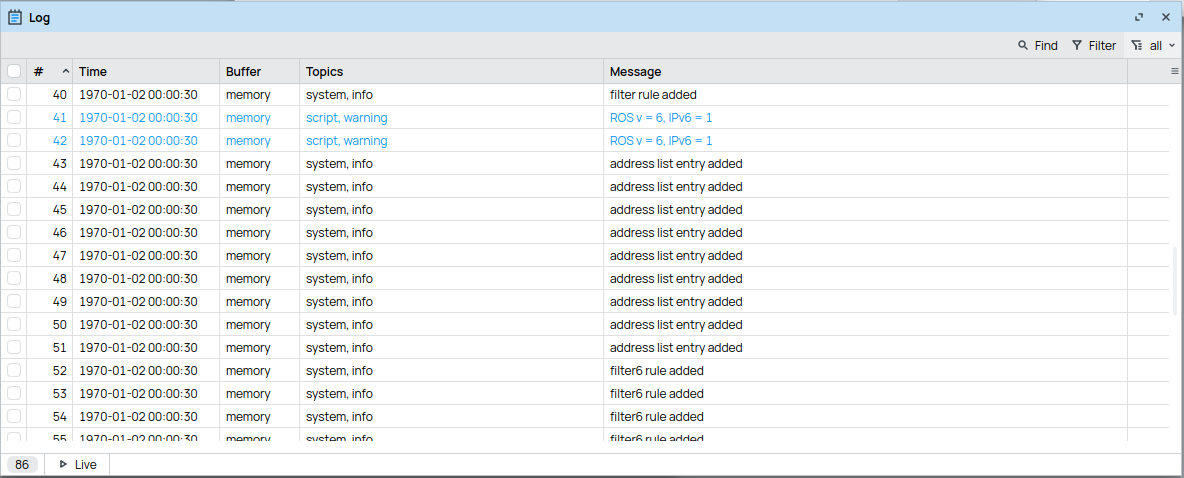

I have prepared default configuration script for branding with IPv6 enable/disable check depending on ROS version:
:local rosv [:pick [/system resource get version] 0 1];
:local ipv6 0;
:if ($rosv = 6) do={
:if ([/system package get ipv6 disabled] = false) do={
:set $ipv6 1;
:if ($rosv = 7) do={
:if ([/ipv6 settings get disable-ipv6] = false) do={
:set $ipv6 1;
:if ($ipv6 = 1) do={
/ipv6 firewall {
But this doesn't work on IPv6-disabled routers.
On IPv6-enabled it works.
How to include IPv6 configuration part depended on IPv6 enabled/disabled state?
