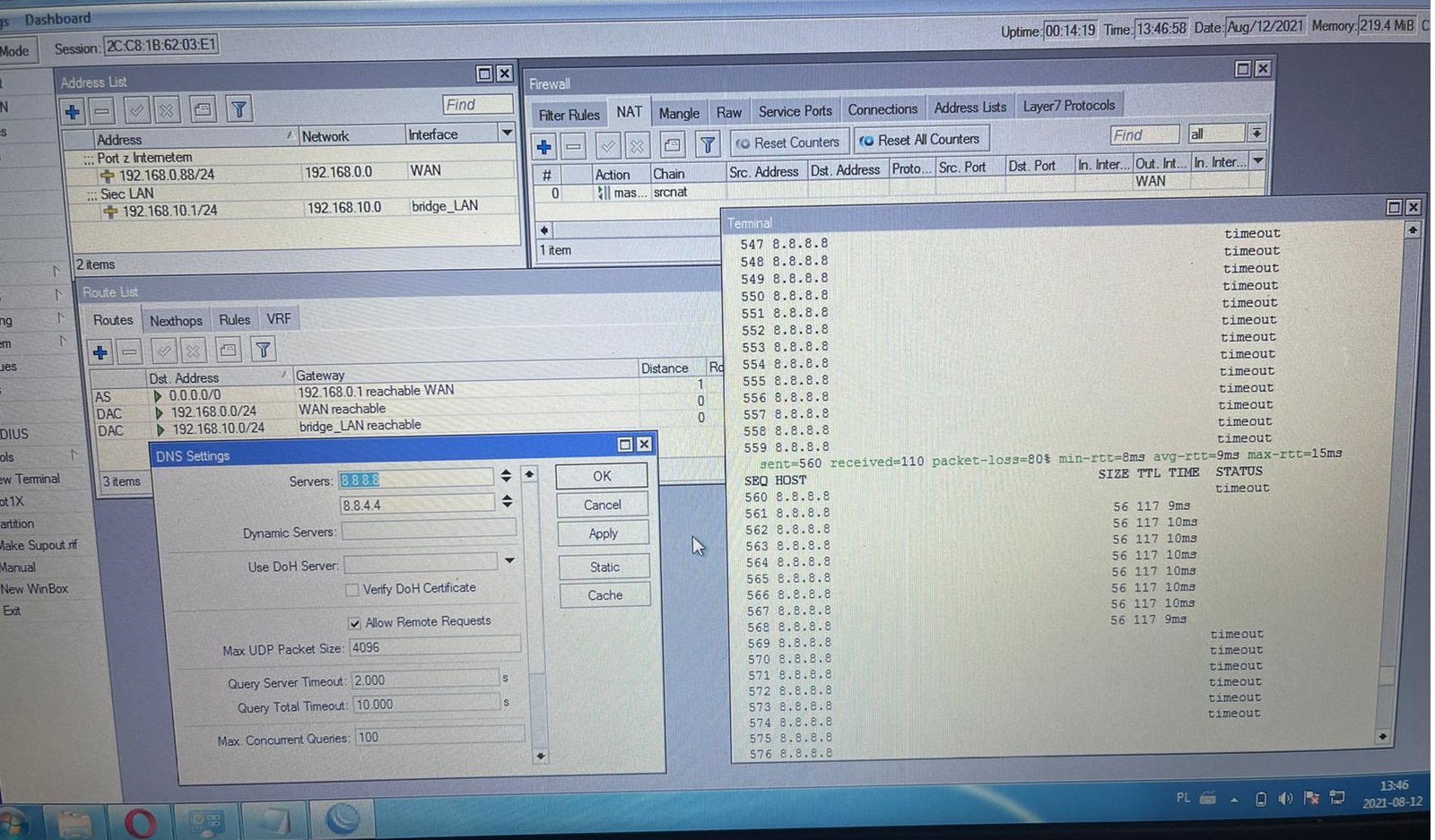

Im starting using MikroTik, i was buy Few tutorial on Internet. I Was make a configuration. Internet working but i have many breaks… wehen i ping 8.8.8.8 i see when i have internet and when not.
I try few different cable (new) so it’s not a cable problem. When i connect Laptop direct to ISP router then internet works fine on laptop.
Any idea ?

I was send picture with all config. All setting are visable on PICS.
But here is export, send me command if this is not full. Im start LEARN this device.

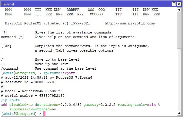

I did a quick export on a Test-System (Foto)
I can read more than you think from on photo (instead of screenshot, and just this is an information),
but I cant read other fields on various parameter because on winbox aren’t exposed directly on the screen.
For example, the RouterBOARD model and the RouterOS version of which you kindly cut on the photo…
0.0.0.0/32 ??? something is wrong…
You use 7 beta, this forum section is for 6.x, the 7 beta has its own section
command and export are not interchangeable

Like u see in picture i ping from MikroTik 8.8.8.8 so mikrotik CUT internet or cant take from TPlink
When i ping same time 8.8.8.8 and 192.168.0.1 - TP link router adress , then in same time show me timeout and good packet so problem is connection with TPlink.
My ISP router is TP Link. I don’t think so the firewall will be problem. Because i have Internet and have breaks.
