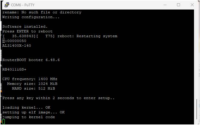

I’ve a 4011 that shows the following message in console.
already tried netinstall with older 6.48 and newer 7.16 exe and npk.
in some firmwares it get freeze in jump to kernel code, others is keeps rebooting with kernel not found or corrupted ..
any suggestions?

Since netinstall seemingly successfully finishes its job, it seems as if flash disk on RB4011 started to fail. So you’d have to replace flash chip, potentially loosing ROS license. So before you do anything more radical than netinstall, I suggest you to contact Mikrotik support (e.g. via support@mikrotik.com) explaining all the circumstances (in detail) and wait for their response.

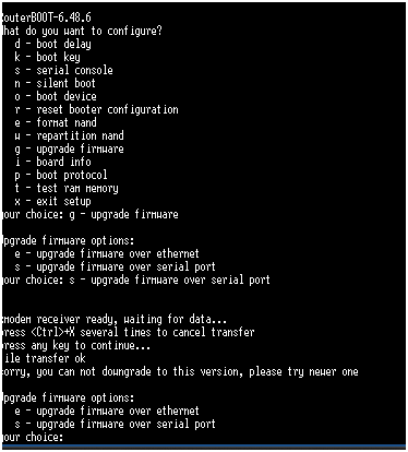

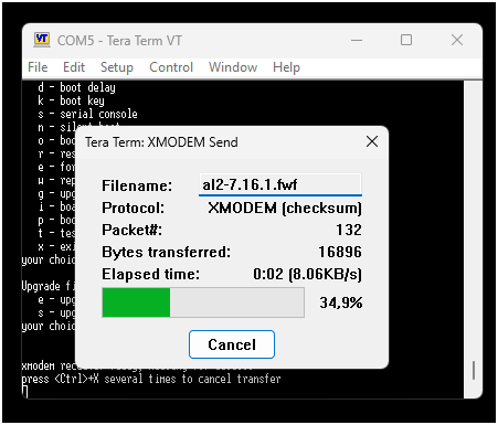

i’ve tried to download a newer fwf version.. but i can’t find.. the newest avaiable for download is al2 3.44.
when the file is uploaded via xmodem, the error is version obsolete.. in the same option, if we upload a .bin file, the error is invalid id file..

RouterBoot version is at 6.48.6. It should be able to boot ROS version 6.48.x just fine (and quite likely ROS v7.y as well).
I still think that the flash storage chip may be failing.

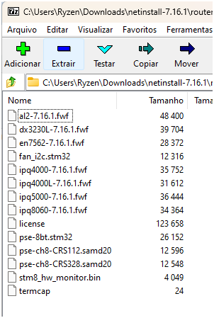

thank you for tutorial to retrieve fwf file, but i’ve found this easiest way in http://forum.mikrotik.com/t/failure-firmware-upgrade-with-netinstall-and-loading-kernel/159083/1 using 7 zip and navigating to folder etc.

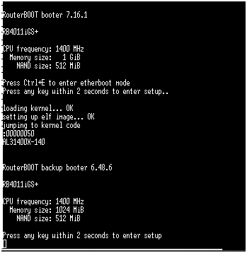

Something curious:
when I reboot it from power with backupbooter - routerboot return from 7.16.1 to 6.48.6

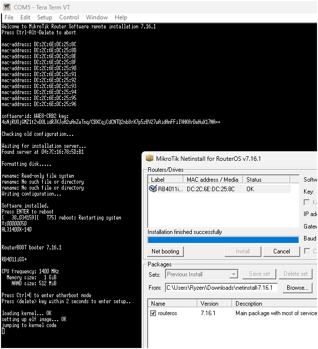

so.. last try, routerboot 7.16.1 and netinstall 7.16.1.. still jumping to kernel code..

You getting…error…
rename: Read-only file system
When netinstall have you tick the options to reset the config ??
Yes, i’ve tried everything in boot options.
Support says that is a nand issue. Unfortunally it is necessary send to rma.
