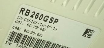

Check the label on the bottom of your switch. The new ones are marked as CSS106-5G-1S (or CSS106-1G-4P-1S for RB260GSP) like this:
My understanding is that these devices use completely different hardware, so 1.17 won’t work on the newer ones (and 2.0 won’t work on the older ones).

Both switches are 260GS. Judging by the label (thanks andriys) they are not the CSS series. Serial number on one of them in case it helps anybody is 416602C96D9F/428.
