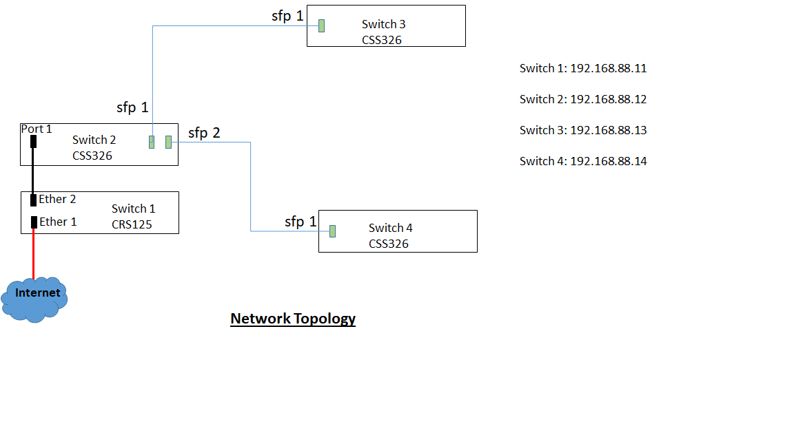

this is network topology:
Some PCs are connected to CRS ports.
no need for VLAN all network connected devices are in the same vlan.
I’ve connected CRS and CSS without configuring CRS device. Only default configuration and IP address change.
All work well; but after 3 or 4 hours any network can access to internet and I can not connect to any switch configuration interface.
but all connected device reply correctly to ping command (ping works).
what’s wrong in this configuration

pleased find below network topology.

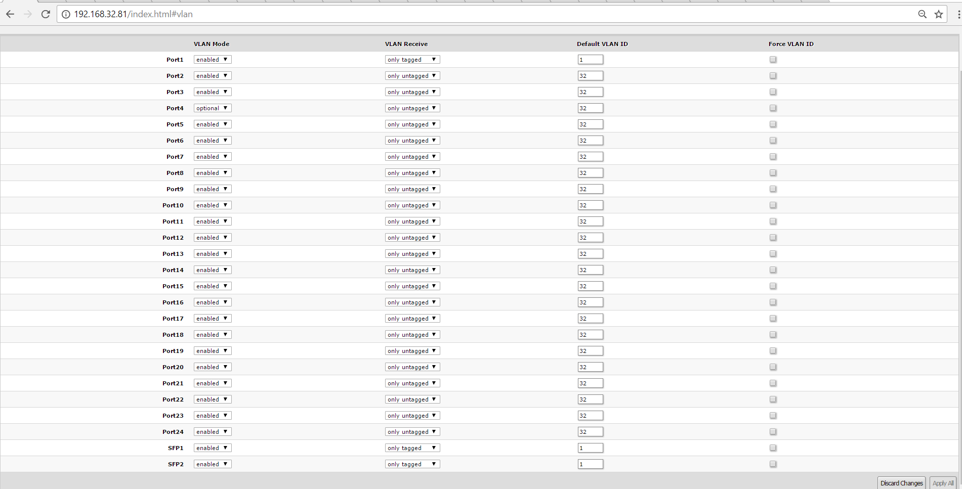

CRS configuration
CSS configuration Bellow
This is the problem:
When I connect fiber to Mikrotik switches and make a bridge with existing dlink switches all PC connected to dlink switches everything work fine. But when I connect PC to switch 1 and switch 2 network drops. pings respond correctly but no application is working: internet access, exchange, accounting, etc. And I can not access to switches management interface.
pleased can someone help me solve this problem.
