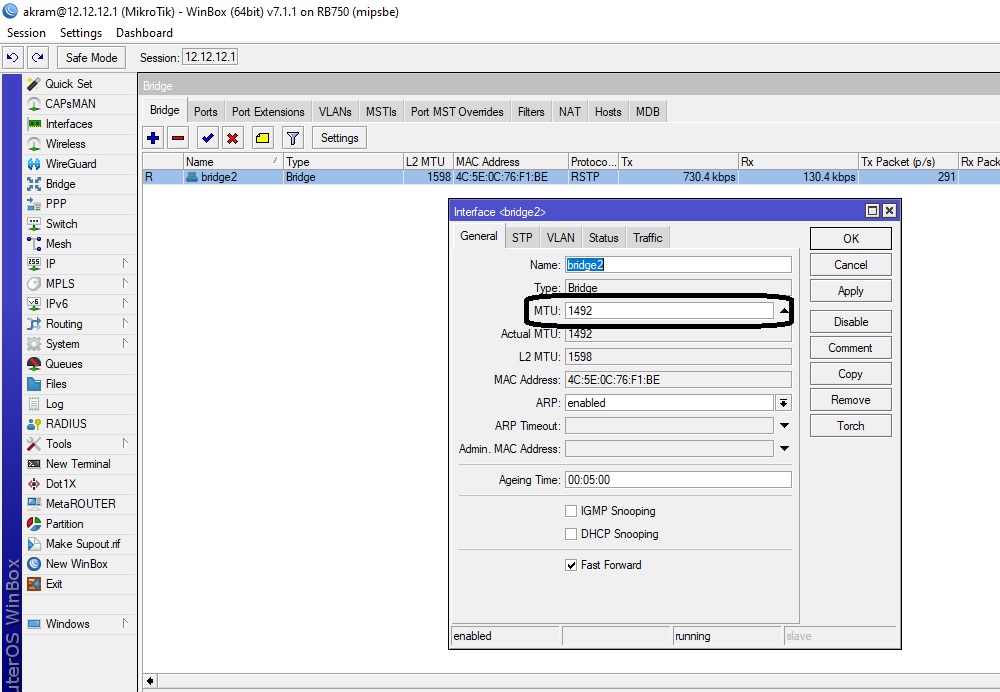

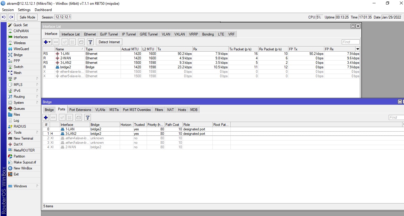

First thing to do is update your firmware to latest long term firmware 6.49 something I believe.
You only need one bridge, the other one I see is disabled.
All ports should be on bridge 2 except the WAN port ether2.
Remove ether2-wan from any bridge.
Your interface lists, list members and firewall rules are a mess, in fact I dont think your firewall rules are particularly safe at the moment.
Upgrade the firmware and try to clean up your interface lists and firewall rules and repost again.
ok i upgrade to 7.1.1 and remove all the mess up of the firewall.
still the same issue I cannot open the yahoo site and some other sites.
so u accept to check with me by anydesk and we can contact by whatsapp if it’s not against any rules
Smells more like MTU issue on the PPPoE link.
I recall long time ago I had the same, some HTTPS sites would just not work.
but it work when i put an IP address in the WAN range and the sites open
you were right it is MTU issue ,I called the ISP and they give me MTU on ISP Router to put on in it and then I put the same MTU on my Bridge settings ,it’s fixed guys
thanks guys
here is the MTU I put in both ISP router and Bridge
You got an MTU issue…
The Bridge2 MTU is 1420 Byte, i can see that on post #10
Set the Bridge MTU to 1500Byte…
