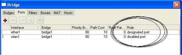

Hi all,
I have a problem with one RouterOS.
I created 6 bridge in 6 machines and always have ether1 like root port and the wlan1 disabled port (because no users connected, it’s ok..) but.. I have problems in one machine (My machine number 7) because ether1 is like designated port and wlan1 is designated port too. Why? what’s the problem? all machines have same components/configurations.
Thanks.
Martín.

Look at the picture to see roles
Anyone can help me whit this?
finally I fix the problem. One ethernet pair was broken. We changed the ethernet wire and all is working fine.
Just connect to the W-LAN, then it’s a designated port :slight_smile: It’s getting changed automatically…
