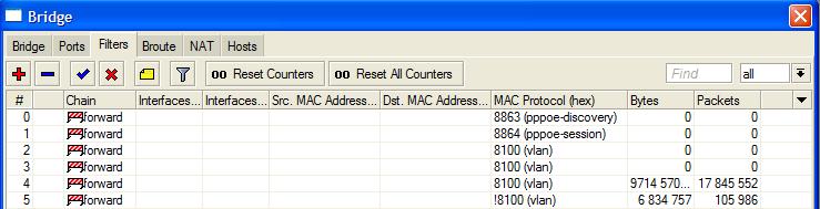

 /interface bridge filter> print
 0   chain=forward action=mark-packet new-packet-mark=pppoe-discovery mac-protocol=0x8863
 1   chain=forward action=mark-packet new-packet-mark=pppoe-discovery mac-protocol=0x8864
 2   chain=forward action=mark-packet new-packet-mark=pppoe-discovery mac-protocol=vlan vlan-encap=0x8863
 3   chain=forward action=mark-packet new-packet-mark=pppoe-session mac-protocol=vlan vlan-encap=0x8864
 4   chain=forward action=mark-packet new-packet-mark=ALL-VLANs mac-protocol=vlan
 5   chain=forward action=mark-packet new-packet-mark=ALL-VLANs mac-protocol=!vlan
ROS v3.14
the problem is 0,1,2,3 does not see anything and count.
actually the bridge filter can not see any tagged vlan and the count of number 4,5 is just for untagged vlan
this is a bug.

yes i am sure . it is just a bridge with 2 ports . ether1 and ether2 showing correct traffic. i have tested all chains but no success .

ADSL users =====  SWITCH (tagged and untagged VLANs ) ==== Mikrotik Bridge ======  Mikrotik PPPOE server === internet
the configs i sent is for Mikrotik Bridge .
Yes I misspoke. Why are you trying to mark the packets on the vlans? Are you sure you have PPPoE traffic on the vlans going over the bridge?
of course i have pppoe traffic on the vlan over that bridge. one example reason is limit the pppoe discovery packets. and some other reasons.
