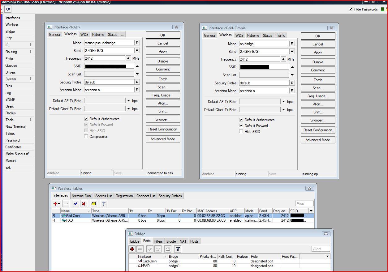

I have it confed as follows:
And it seems it doesnt work.
Pad is connected to a ROS Box doing PPPOE server.
Omni is connected to client. PPPOE client cannot get through.
Directly connected to same device as the Pad interface is the client is able to do PPPOE.

Ok and for the new findings.
Seems to now be working perfectly!?!
No idea why i had the issues.
Using v3.4.
