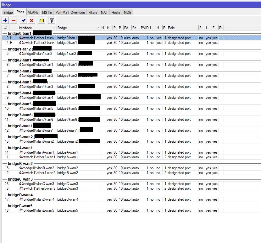

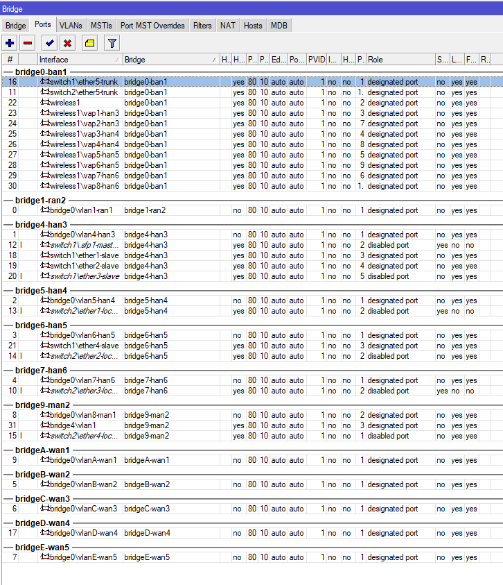

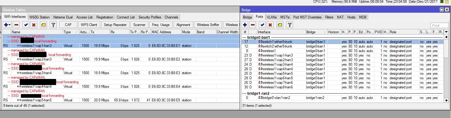

I attached more detailed pictures of my setup.
I really don’t know why this is happening. Surprisingly, this situation does not occur on different bridges, only on the first one(trunk).
Sorry, I could not reply earlier.

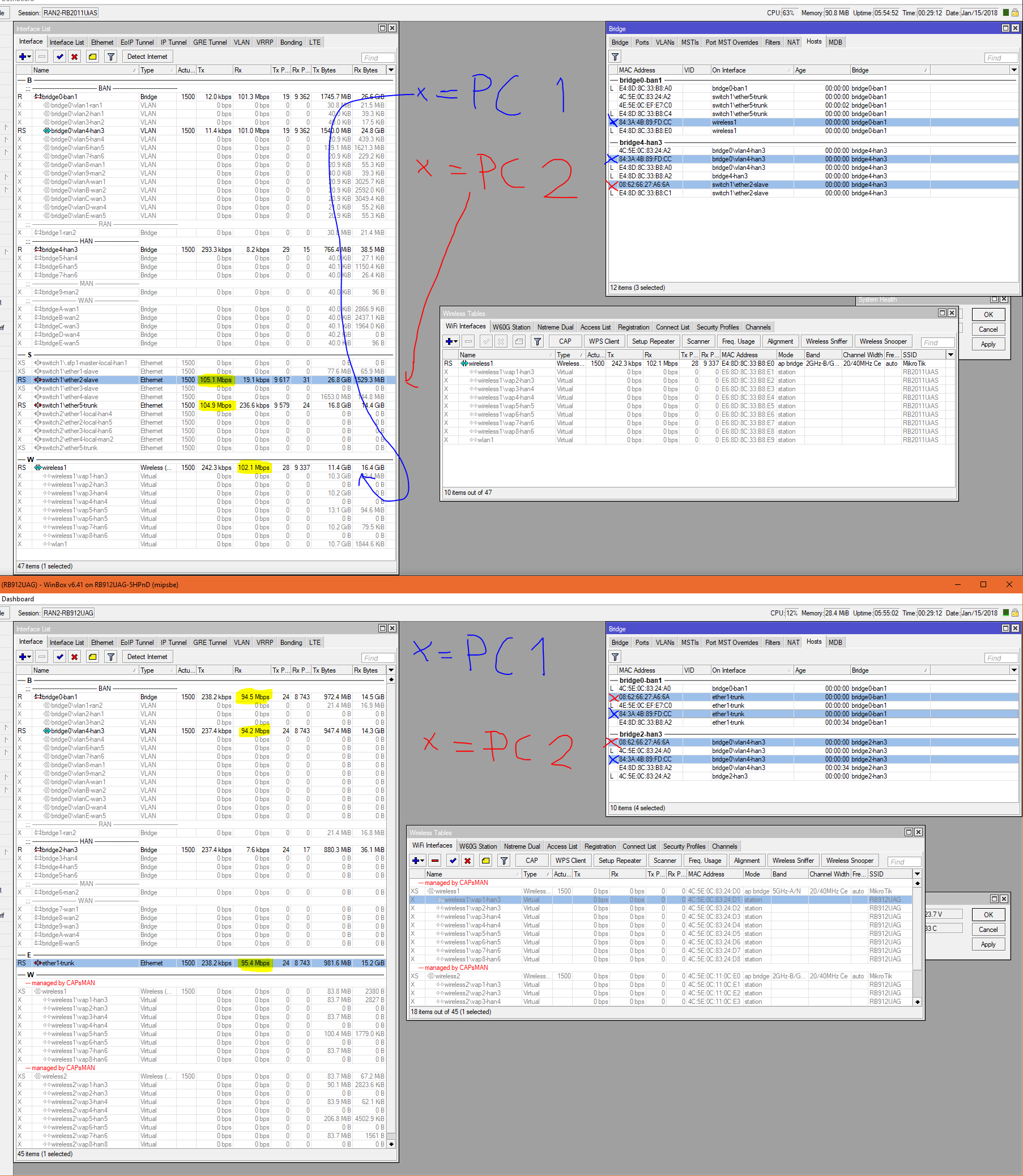

I directly connected RB2011 with RB912, disabled every interface, besides those which you can see in the picture.
Then set up only one Wireless interface(wireless1 on RB2011) with VLAN Tagging 221. That wireless interface is part of bridge “bridge0-ban1”(trunk) on RB2011.
Then connected one PC wirelessly, another via Ethernet to “switch1\ether2”(which is part of “bridge4-han3” on RB2011 as well) and started btest between them.
The problem occurs even then. You can see that on RB912 which is connected to “switch1\ether5”(part of “bridge0-ban1” on RB2011). RB912 can hear everything, even though both clients are NOT connected to him.
As you can see, “bridge0-ban1” on RB2011 don’t know where to find “PC 2”, because VLAN interface “bridge0\vlan4-han3” is not part of the bridge. I mean, he is not a port of that bridge. He is like a part of himself. I think this is the problem.
