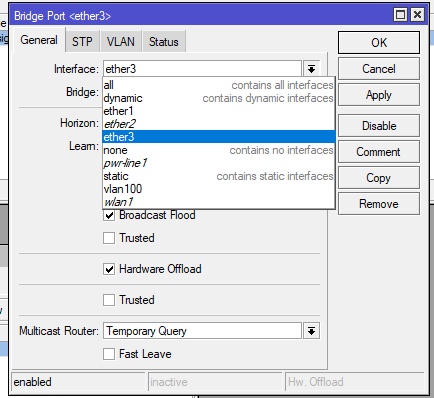

I am unable to add the Bridge itself under /interface bridge port:

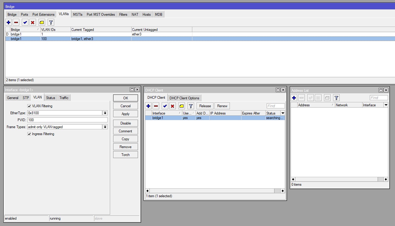

If I set the Bridge as tagged VID100 under /interface bridge vlans no DHCP-IP will be assigned:

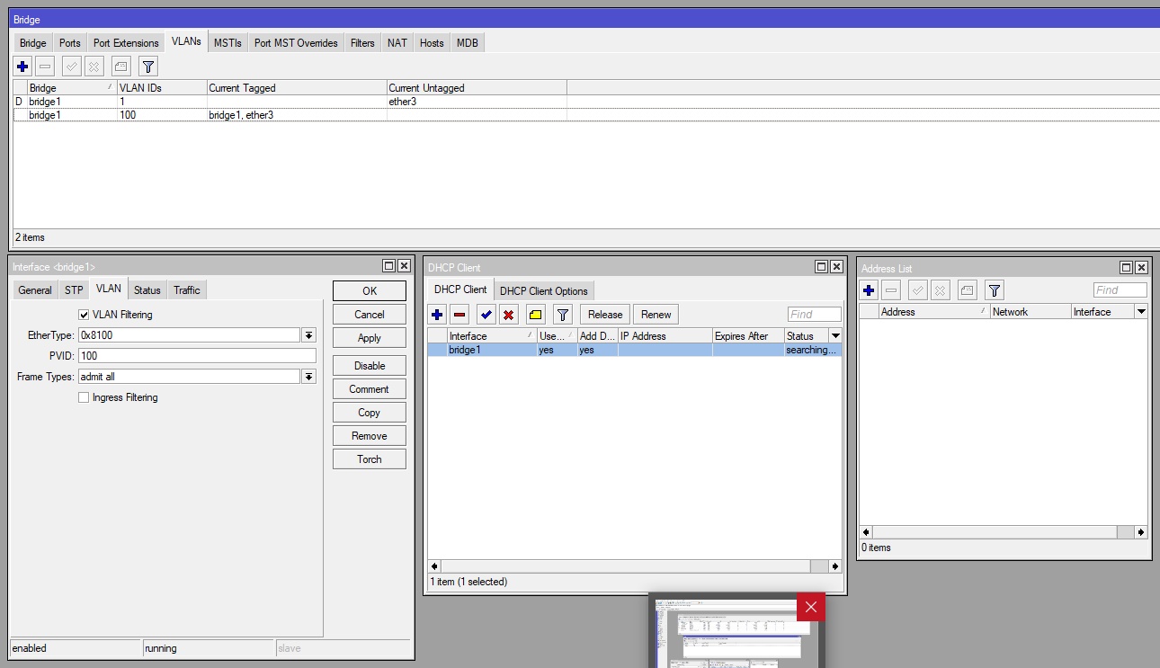

Setting the Bridge tagged and “admit only VLAN tagged” + “Ingress Filtering”, same result. No connectivity:

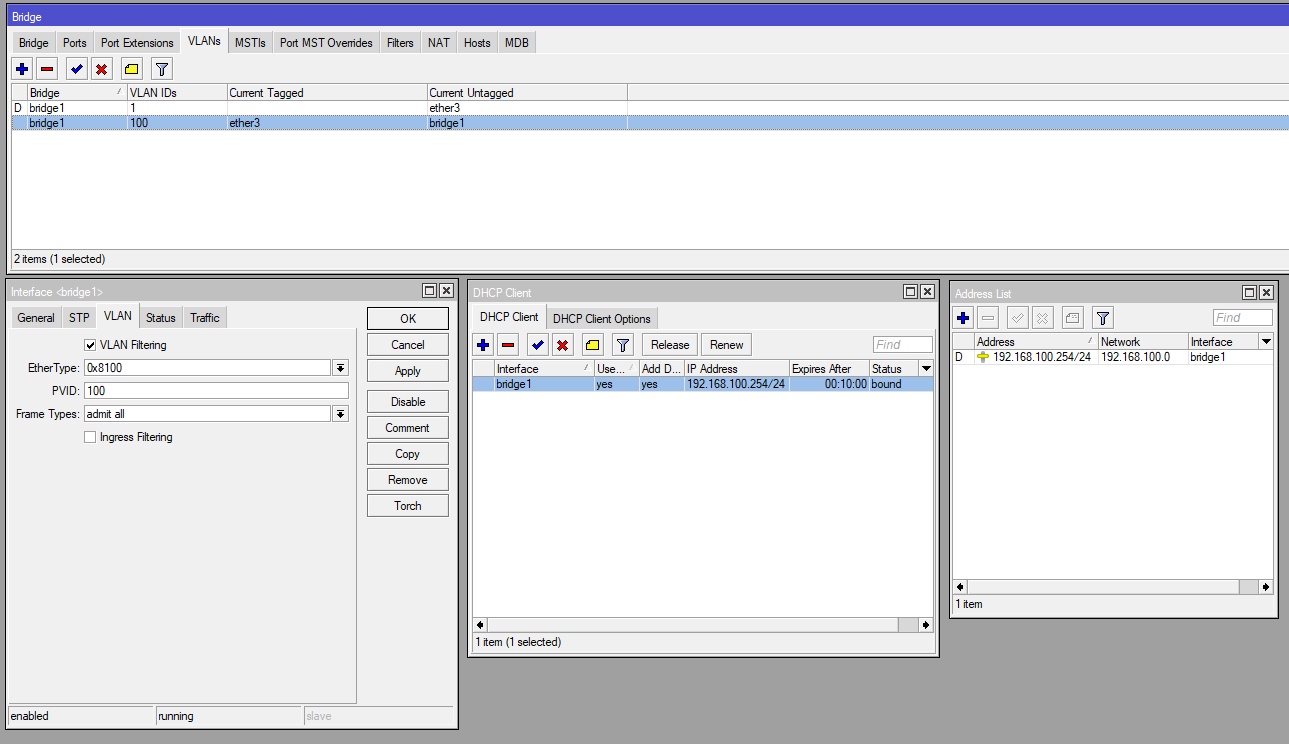

If I set the Bridge as untagged, the IP will be assigned via DHCP:

If you configure the CPU-to-bridge port/interface to be tagged then you need to something to encapsulate/decapsulate the VLAN, e.g.
/interface vlan
add interface=bridge1 name=bridge-vlan-100 vlan-id=100
and attach the IP address, DHCP server, firewall rules, etc. to this - anything attached directly to the CPU-to-bridge port/interface will only handle the untagged traffic
