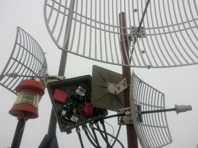

Hello There! I have done a PtP wireless links with router board RB433 with two wlan cards R52HN (dual chain). I have done ap-bridge wireless configuration mode on RB433 board and station bridge on the another sites. All the other station sites are at different directions. So i decided to utilize the dual chain R52HN radio cards with single chain 24dBi grid antennas for different location based station directions that is four different directions with chain0 connectors to two directions and chain1 connectors to another two station directions. For chain0 link connectivity at station end i have used Mikrotik groove52Hpn having single chain0 and link connected good with Rx/Tx signal strength -65/-63dBm. For chain1 connectivity i am using Mikrotik dual chain DISC Lite 5 with activating both chain0 and chain1 on this station end, as there is no radio with single chain1. But chain1 is not making link from AP base site to this dual chain DISC Lite 5 station. It must link at least with chain1 on this dual chain DISC Lite 5 station. Why this is so it must detect the station and get connected? Any link connectivity technical support will be appreciated from Mikrotik Wireless Network Expert here. Thanking you.
