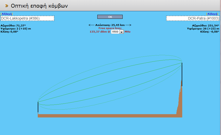

I want to connect two sites wireless at a distance of 25,45 Km.
Site A has a broadband Internet connection and some local services like a private CRM and a telephony system. Furthermore the internet router has a dhcp service.
Site B has one desktop and a wireless access point where some wireless devices connects.
I want these devices to connect to the internet and my services through this wireless link.
I have attach an image with the link and the line of sight is clear.

Add a bridge to each groove
Add the WLAN and Ethernet ports to the bridge
Set one WLAN to mode station-bridge and the other WLAN to mode bridge.
Add a dhcp client to each bridge
