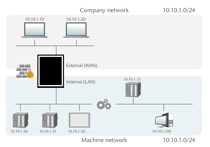

is there a Mikrotik Router which allows to accomplish following setup?
In the bridge operating mode it acts as a layer 2 switch and allows packet filtering in this operating mode.
This means that the restriction of access to individual areas of your network can be achieved without having to use different networks for this purpose.
In the Bridge operating mode, it behaves like a layer 2 switch between the machine network (automation cell) and the company network.
The IP addresses in the company network are in this case in the same IP address space (subnet) as the addresses in the machine network.
Access between the two network areas can be limited or secured with packet filters and MAC address filters. This allows the separation of part of the
company network without using different network addresses.
How may this config look like? Which hardware can accomplish it?

please find attached the config as proposed. Howerever, the firewall has no effect as the plcs are still available from outsinde.
Is it possibel that the internal switch is responsible?
