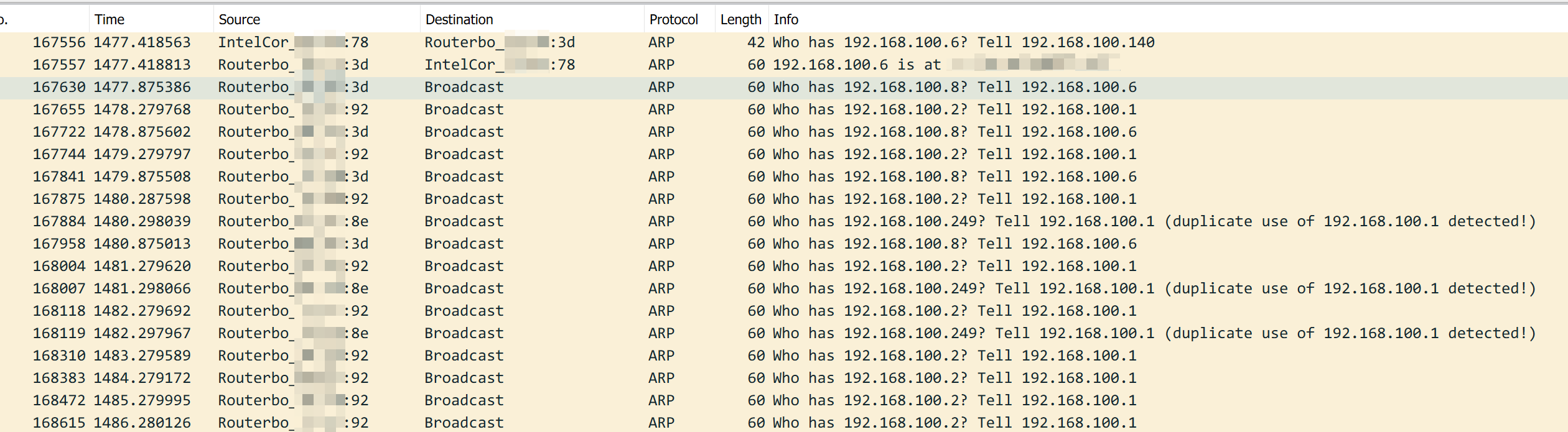

I have a bridge, added multiple ethernet ports to it, forced MAC address using admin MAC and only added IP address on the bridge itself. Some devices randomly cannot ping gateway so I captured ARP messages on the bridge. I noticed the routerboard is sending ARP requests from multiple MAC addresses from admin MAC AND ports’ native MAC.
Board: RB3011 UiAS-RM
OS: RouterOS 6.42.1
(You can see multiple ARP requests stating itself to be 192.168.100.1 but they are actually from the same bridge. All devices are trusted so no possibility of ARP attack.)

Also setting the bridge ARP mode to reply-only has no effect (still duplicated ARP packets). Maybe a switch chip firmware bug?

I have tried set arp mode to disabled or reply-only, it only disables the normal ARP messages sent from bridge MAC, no effect to these bad ARP messages sent from the port MAC.
