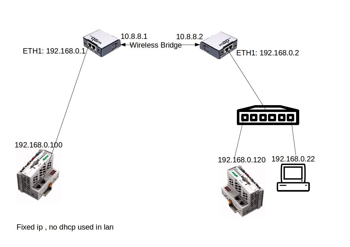

Can anyone help me out ?
i need to make a wirless connection like in the attached documeny
PLEASE see attachment
Where is the problem? you connect wireless in mode bridge – station-bridge and add eth1 and wlan1 to bridge.
i followed this procedure: wireless do not connect
https://spiderwebsolutions.com.au/point-to-point-p2p-link-mikrotik-routeros
if there is a simpeler or better way please help me out with step by step procedure.
best regards
thanks in advance
koen
Looking at your picture, I have to say that there is no reason for ip configuration, if you really want to have a bridge… Just bridge all involved interfaces together and it will work nicely. If not, you did something above that. Of course the wireless has to be linked…
