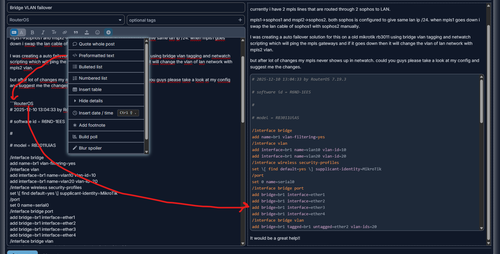

Please use "preformatted text" tag < / > when you post the code to make reading easier. Already did it for you.
You can just mark a block of text and press < / > button or start & and the block of text with 3 backticks (not ticks - the difference is as between backslash and slash).
When you add additional "RouterOS" indice just after the opening backticks, then te code gets fancy colored style.
