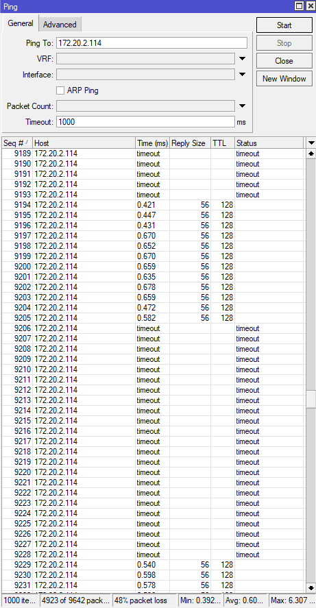

Connectivity issue from main router to printer looks like this:
I can understand that this is might be a problem with this printers, but i cant refuse to use this printers because they attached to tax service and at the same time i need vlans to isolate guests. I even dont know where to dig next to solve this problem. I will appreciate any advice. Thank you.

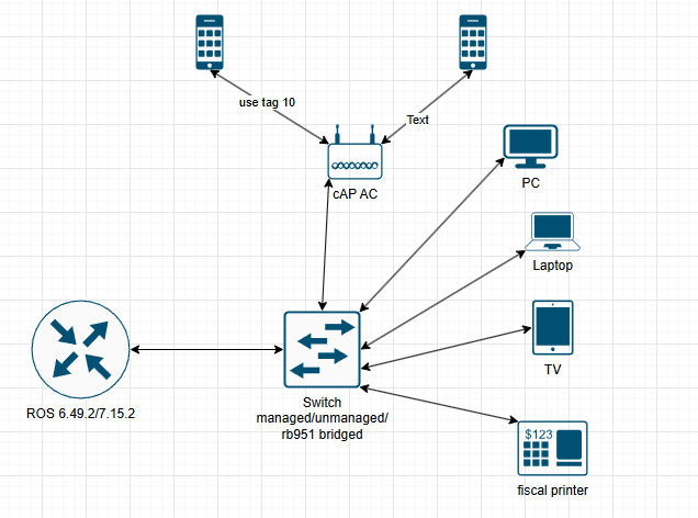

Can you provide some clarity on the diagram.
What is the product on the far left, is that your router??
Does it get a public IP from the ISP?
Does it provide DHCP for the entire network?
The device behind it, the switch, is actually an Access point with 5 ports, please confirm you are using this solely as a switch and why you use the word unmanaged is beyond me.
Its going to be a managed device.
Yes, i have CCR1009, RB3011, RB-951. CCR on ROS 6.49.13, RB3011 on ROS 7.15.2, RB951 on ROS 7.15.3, all in different locations all have same symptoms.
Yes it did.
Yes
Main router → switch(no matter what swtich CSS-326, RB-951 with bridged ports or TP-LINK TL-SF1008D(unmanaged) tried all of them - nothing changed). PC/Laptop/TV/printer/cAP AC conected to this switch.
With that said,
I need three configs. THe mt router, the switch(ap)< and the Capac.
cAP AC is for example to show why i need vlans. In my lab i excluded cAP AC and problem still presist.
