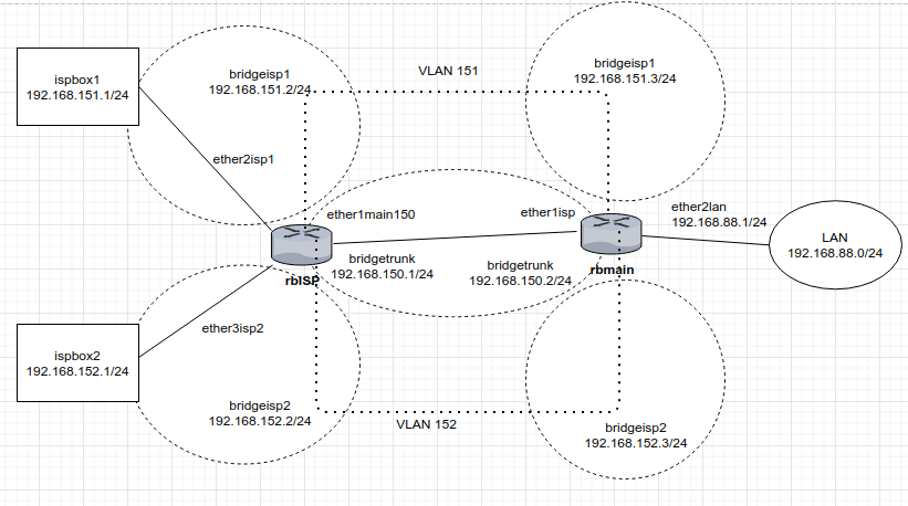

This setup was working well before replacing an HEX GR3 with an HEX lite in a real world scenario, then I reproduced the environment with Virtualbox and CHRs, that desn’t work as well.
This is a schema of the configuration (I hope enough clear):
Obviously, I would like to get one broadcast domain for network 192.168.151.0/24 and one for 192.168.152.0/24 but the ping fails.
On the “rbISP” side, only in the real world scenario:
I’m able to ping ispbox1 before adding vlan151 interface on bridgeisp1
I’m able to ping ispbox2 before adding vlan152 interface on bridgeisp2
I’m sure, I’m missing some configuration hint on the bridge to make it work.
Replacing the two VLAN with two EoIP tunnels the setup works perfectly, but my idea is that EoIP produces a protocol overhead much bigger.
Thanks for your help.
I’m also posting rbISP and rbMAIN configurations:

If the configuration was unchanged between the original hEX Gr3 and hEX lite the most likely cause is the different MAC addresses changing the spanning tree topology - try setting protocol-mode=none on all of the bridges. This is one of the issues discussed here https://wiki.mikrotik.com/wiki/Manual:Layer2_misconfiguration
As the legacy method does not use hardware switching the recommended approach would be to reconfigure with a single VLAN-aware bridge.
