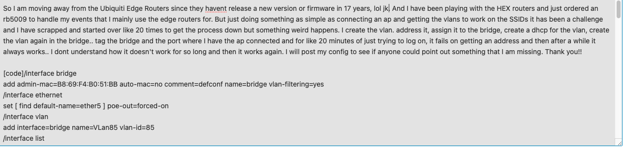

So I am moving away from the Ubiquiti Edge Routers since they havent release a new version or firmware in 17 years, lol jk. And I have been playing with the HEX routers and just ordered an rb5009 to handle my events that I mainly use the edge routers for. But just doing something as simple as connecting an ap and getting the vlans to work on the SSIDs it has been a challenge and I have scrapped and started over like 20 times to get the process down but something weird happens. I create the vlan. address it, assign it to the bridge, create a dhcp for the vlan, create the vlan again in the bridge.. tag the bridge and the port where I have the ap connected and for like 20 minutes of just trying to log on, it fails on getting an address and then after a while it always works.. I dont understand how it doesn’t work for so long and then it works again. I will post my config to see if anyone could point out something that I am missing. Thank you!!
add admin-mac=B8:69:F4:B0:51:BB auto-mac=no comment=defconf name=bridge vlan-filtering=yes
set [ find default-name=ether5 ] poe-out=forced-on
/interface vlan
add interface=bridge name=VLan85 vlan-id=85
add comment=defconf name=WAN
add comment=defconf name=LAN
/interface lte apn
add name=dhcp ranges=192.168.88.10-192.168.88.254
add name=dhcp_pool1 ranges=192.168.66.10-192.168.66.250
add name=dhcp_pool2 ranges=192.168.23.10-192.168.23.200
add name=dhcp_pool3 ranges=192.168.188.50-192.168.188.254
add name=dhcp_pool4 ranges=192.168.150.50-192.168.150.250
add name=dhcp_pool5 ranges=192.168.130.2-192.168.130.254
add name=dhcp_pool6 ranges=192.168.85.2-192.168.85.250
add address-pool=dhcp interface=bridge name=defconf
add address-pool=dhcp_pool6 interface=VLan85 name=Vlan85
/port
set 0 name=serial0
/queue simple
add max-limit=50M/50M name=queue queue=pcq-upload-default/pcq-download-default target=192.168.66.0/24
/routing bgp template
set default disabled=no output.network=bgp-networks
/routing ospf instance
add disabled=no name=default-v2
/routing ospf area
add disabled=yes instance=default-v2 name=backbone-v2
add bridge=bridge comment=defconf ingress-filtering=no interface=ether2
add bridge=bridge comment=defconf frame-types=admit-only-untagged-and-priority-tagged interface=ether3 pvid=66
add bridge=bridge comment=defconf ingress-filtering=no interface=ether4
add bridge=bridge comment=defconf interface=ether5 trusted=yes
add bridge=bridge comment=defconf ingress-filtering=no interface=sfp1
set discover-interface-list=all
/ipv6 settings
/interface bridge vlan
add bridge=bridge tagged=bridge,ether5 vlan-ids=130
add bridge=bridge tagged=bridge,ether5 vlan-ids=85
/interface detect-internet
set wan-interface-list=WAN
/interface ovpn-server server
set auth=sha1,md5
add address=192.168.88.1/24 comment=defconf interface=bridge network=192.168.88.0
add address=192.168.85.1/24 interface=VLan85 network=192.168.85.0
/ip dhcp-client
add interface=ether1
add address=192.168.85.0/24 gateway=192.168.85.1
add address=192.168.88.0/24 comment=defconf gateway=192.168.88.1
set allow-remote-requests=yes
/ip dns static
add address=12.1.35.167 comment=defconf name=router.lan
add action=accept chain=input dst-port=8291 protocol=tcp
add action=accept chain=input comment="defconf: accept to local loopback (for CAPsMAN)" dst-address=127.0.0.1
add action=accept chain=forward connection-state=established,related dst-address=192.168.60.0/24 protocol=icmp src-address=192.168.23.0/24
add action=drop chain=forward dst-address=192.168.23.0/24 src-address=192.168.66.0/24
add action=fasttrack-connection chain=forward comment="defconf: fasttrack" connection-state=established,related hw-offload=yes
add action=accept chain=forward comment="defconf: accept established,related, untracked" connection-state=established,related,untracked
add action=drop chain=forward comment="defconf: drop all from WAN not DSTNATed" connection-nat-state=!dstnat connection-state=new in-interface-list=WAN
/system clock
set time-zone-name=America/New_York
/system package update
set channel=testing
/tool mac-server
/tool mac-server mac-winbox
