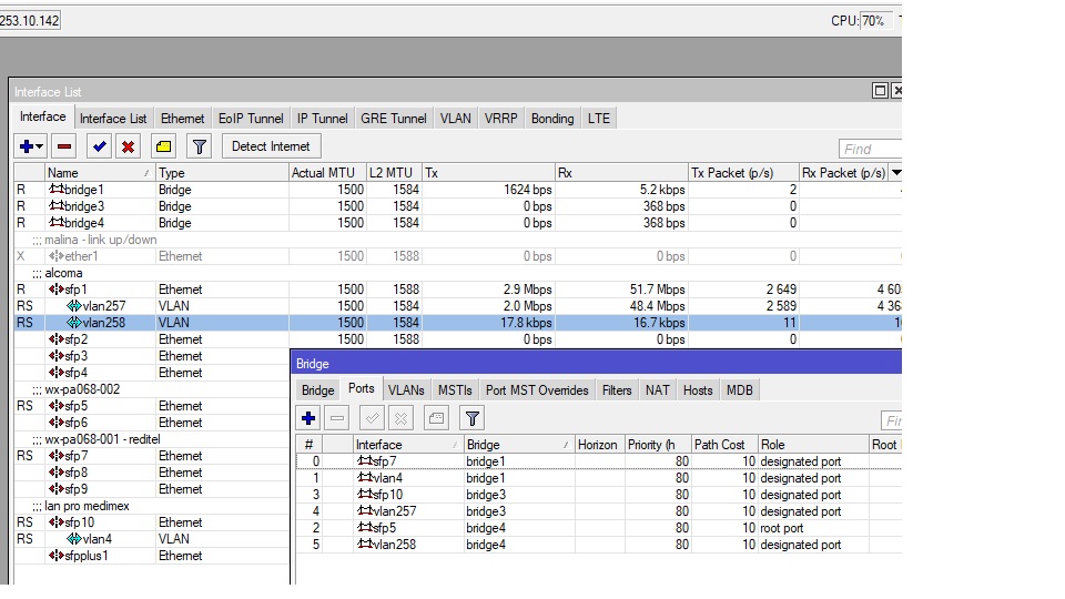

I catch tagged trafiic on sfp1(vla257), utagg and send to sfp10. Behind sfp10 is next mikrotik(customer router) which send to me tagged traffic(vlan4). I want untag and send to any other sfp.
I solved this only with bridge. See attachments. It overload cpu.
