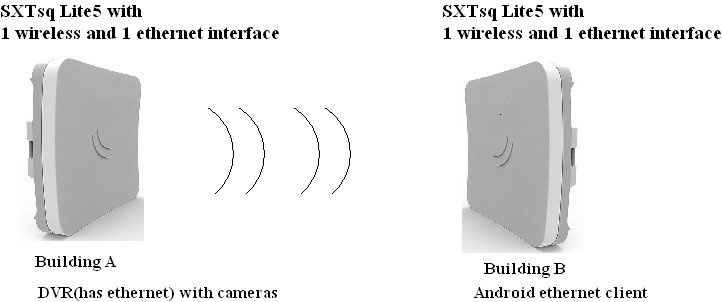

Hi to all,
I need to carry DVR video stream one building to another building wireless. I will use SXTsq Lite5 at each building .There is no internet connection or modem exist at buildings so there is no DHCP server ready at the beginning. How can create DHCP server at bridge and give the IP’s to the another building. I cannot create DHCP server at the building A at the bridge 1. What would be my strategy or is there any script to apply according to my scenery?

I think you should:
Building1:
  • Create a bridge with all the wireless and ether1 interfaces
  • Create an static IP address for this bridge
  • Create a DHCP Server for this bridge (First the pool if you prefer to do not use wizard)
Building2
  • Create an IP address for the bridge (Static or DHCP Client)
In this case, DHCP Server will be in building1, if you will have more devices in building2, maybe should be better to create the DHCP on building2
Regards!
Damián
