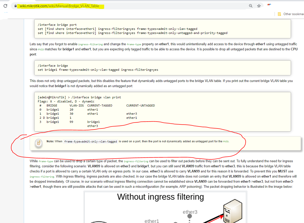

bridge1 dynamically being added as an untagged port.
I am following this: https://wiki.mikrotik.com/wiki/Manual:Bridge_VLAN_Table
It states that:
Note: When frame-type=admit-only-vlan-tagged is used on a port, then the port is not dynamically added as untagged port for the PVID.
But i am still getting it added as an untagged port. What am I missing?
Full export and print below:

Does this mean the wiki is incorrect?
Which part of which document do you have in mind?
Please refer to attached pic
As it turns out my belief was inacurate. If I changed setting on bridge to frame-types=admit-only-vlan-tagged then the implicitly set vlan (implicit pvid=1 setting on bridge) disapears from output of command /interface bridge vlan print. Which means wiki is right and I was wrong, one can create tagged-only bridge interface.
