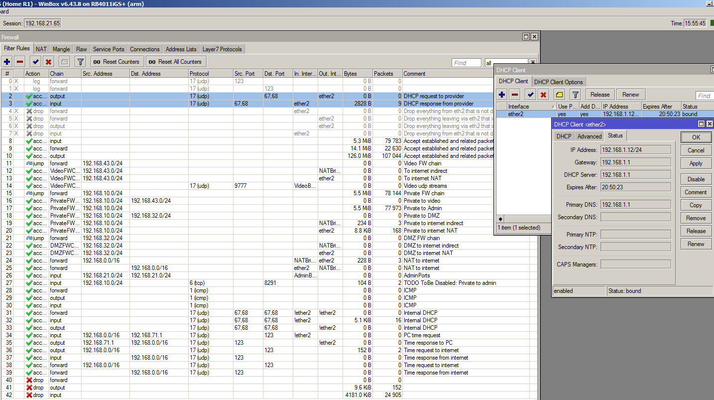

OK so I understand this is not possible, have resolved it on the connection level in a way that on each Mikrotik there are 2 physical ports (ETH10 and SFP) connected to bridge and everything is handled by this bridge, however in case both ports are connected it really do not work.
For internet connectivity I use only one port eth2 on R1.
Now I started to configure FW and got problems from the beginning there are 2 simple rules setup:
RULE 1: UDP out to ETH2 to ports 67 and 68
RULE 2: UDP in from eth2 from ports 67 and 68
And to these rules there is DHCP client configured for eth2
Now when I connect this router to box of my provider via ETH2 I got 0 (zero) packets on the out connection and 9 (+ growing) on the incomming connection, obviously I’m asking myself how it is possible that router gets IP address assigned from provider without asking for one?
Thanks for explanation
In dhcp protocol, server is on 67 client on 68, UDP.
So what you should to is, allow outgoing (chain=output) to 67 and then allow “established & related” on inbound (chain=input). Connection tracking will take care of the rest.
Did your config on primary router (connected to isp) change? If so post last version (/export hide-sensitive compact).
Is the isp box doing natting (=> 192.168.1.0/24)?
DHCP broadcast, request, etc is layer 2, firewall is layer 3 of OSI model
dhcp protocol is in UDP, based on IP, and using broadcast ip’s when necessary.
See https://en.wikipedia.org/wiki/Dynamic_Host_Configuration_Protocol
True, wasn’t thinking it through properly
Today We have chained 2 Mikrotics, one of them pretending to be ISP and the second one was my R1. In log of the ‘fake ISP’ the broadcast packet of my Mikrotik was clearly seen going from port 68 to 67, BUT the firewall counter stays on 0 packets. What I’m doing wrong?
IP firewall does not affect dhcp client.
See also: http://forum.mikrotik.com/t/firewall-rules-for-wan-interface-dhcp-firewall-rules-without-effect/124362/1
Yes it does…
Do you have a dhcp client? Try to firewall it completely in input for UDP…
Corrected. (that’s new for me)
Accepted before this rule already?
It used to be necessary, as the packets were processed by IP firewall. Today dhcp client traffic doesn’t go through firewall.
