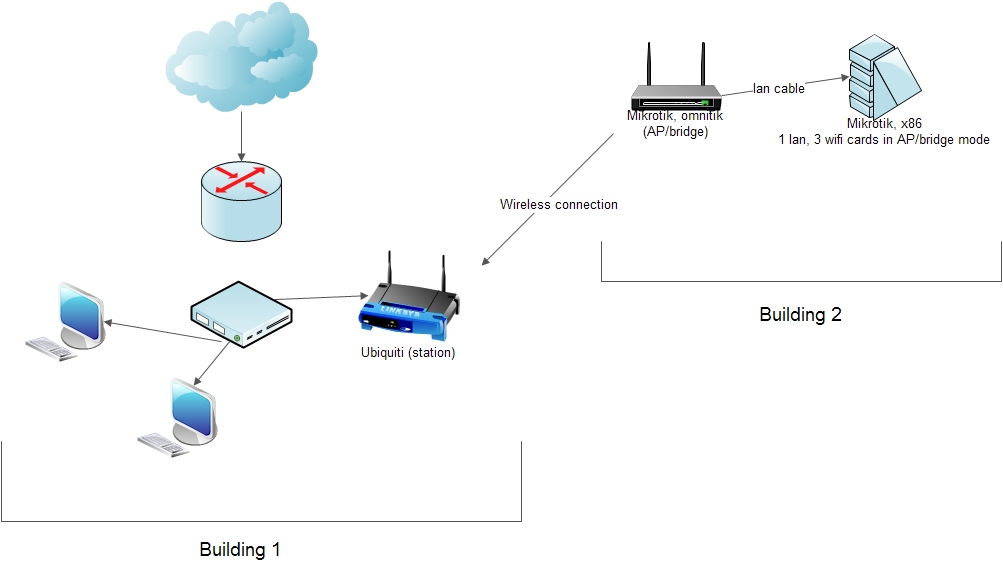

This is map of my network.
In building 1 is broadband router, switch, several computers, and one Ubiquiti CPE on 5 GHz.
Ubiquiti is configured as Wireless client. All these devices are connected with LAN cables to switch.
On building 2, I have OmniTIK, and one x86 Mikrotik.
OmniTIK wireless interface is configured as ap/bridge, wlan0 and ether1 are in bridge
Ethernet cable goes from OmniTIK to x86 Mikrotik.
x86 have 3 wireless cards in AP/brigde mode. All interfaces are in brigde.
In building 1 everything works great.
But, when I connect to OmniTIK or any of wireless signals from x86 Mikrotik, I have problem…
  • I can access broadband router configuration page (this is ok)
  • I get IP from dhcp broadband router (this is ok)
  • I can access computers (ping, file sharing, ..) (this is ok)
  • I can access computers from building 1 in building 1 (ping, file sharing, ..) (this is ok)
  • I cant access internet from building 2 (this is problem!)
I replaced broadband router with another, checked internet connection, and everything works great inside LAN but I can’t access internet…
I know that using NAT and masquerade will solve this problem, but I want to keep everything in same network so this is not good solution for me. I don’t have idea what should I do, I seen for first time something like this…

Is the ubiquiti bridge as well? (I have couple of NS5 in my MT network and these tend not to act very well together. Especially bridging is a troublesome thing and I use routing for those).
Does your devices on building 2 get IP-address from building 1 network? Is it able to access building 1 devices and gateway?
If I use NAT between two buildings, file sharing between clients may become problem.
ubiquiti is in bridge.
Yes, they get IP addresses from broadband router. I can access all computers, and everything inside LAN works, but internet doesn’t.
From your broadband router, do you assign IP’s to all devices in both buildings or just building 1?
From building 1 to building 2, you should have the link in bridge mode and in building 2 from the link antenna into a router that will then assign IP’s to devices.
You do not need or want any other wireless devices in a brige mode, on the link between the buildings.

I don’t need to log in from building 2 to computer located in building 1, but this is not important because this work. All LAN services works without any problems but Internet doesn’t work in building 2 and there is no that I can do.
Problem may be in:
bridges configuration or too much bridges
TTL
or something other… (probably problem with mac addresses)
Check if the MAC addresses travelling through your bridges are preserved or you’ll likely just see all as being the same.
Ok, but this shouldn’t be problem. Packets that need to go outside lan uses default gateway, and it’s accessible (at least on port 80).
