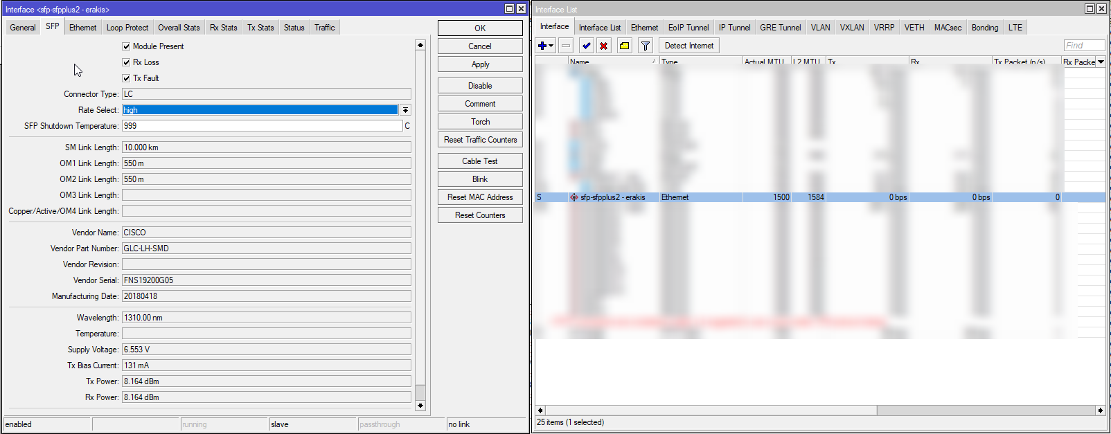

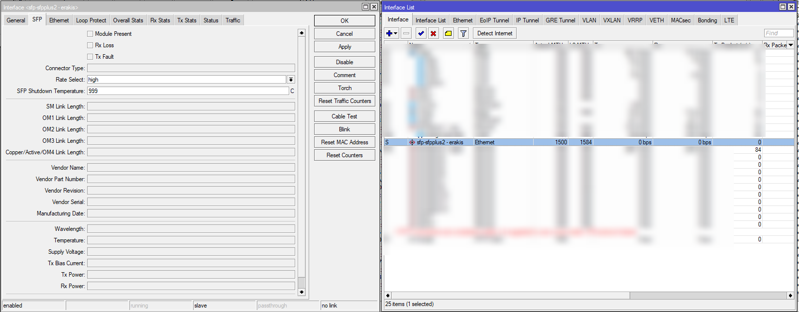

The transceiver is not detected at all

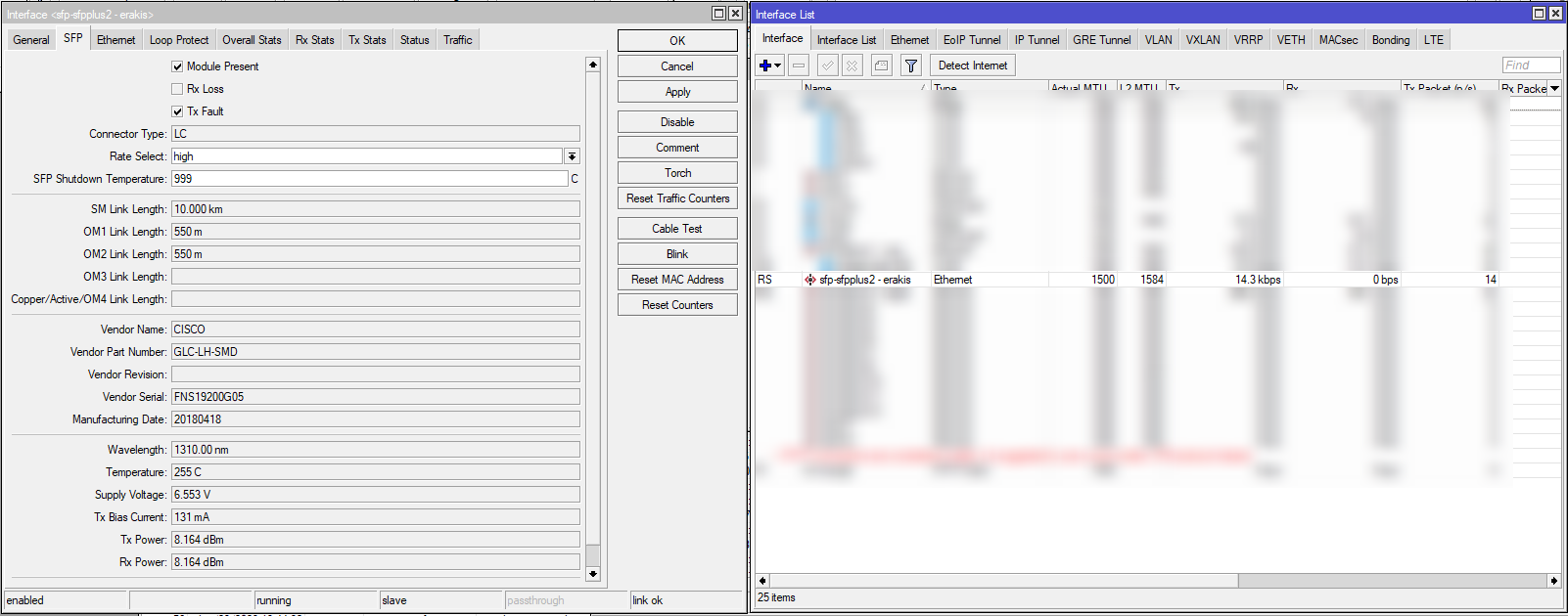

The transceiver is detected and link is finally detected… but… temperature is detected as 255°C

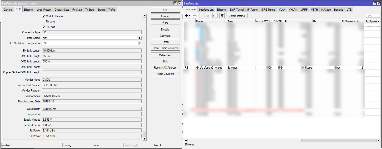

I found a workaround to set SFP Shutdown Temperature at 999°C but it not clean and it is clearly a RouterOS bug.

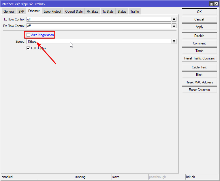

Morover, the transceiver is not anymore plug-and-play and detected as is, I had to disable Auto negociation for link to be OK…

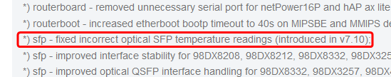

It seems to be fixed since 7.11 (4 major version after…)…
