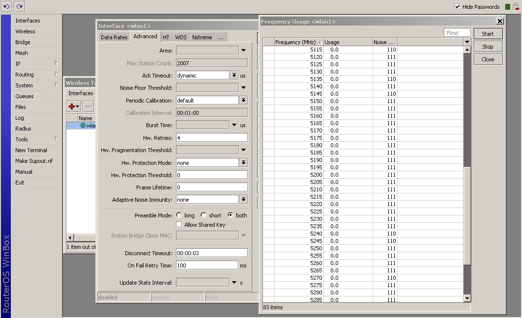

after upgrade from 4.03 то 4.04 my wireless connection via N-card absolutly DEAD in all modes (5 g too) Interface enabled but dont scan nothing.
Try turning off adaptive noise immunity on both sides..
adaptive noise was off
downgrade to 4.03 - everything work again

I Found bug.
In ROS B4 When: ADAPTIVE NOISE IMMUNITY enabled (AP and client mode) then AP don`t connect any CPE. In beta3 when enabled this option then all ok.
we will try to fix it.

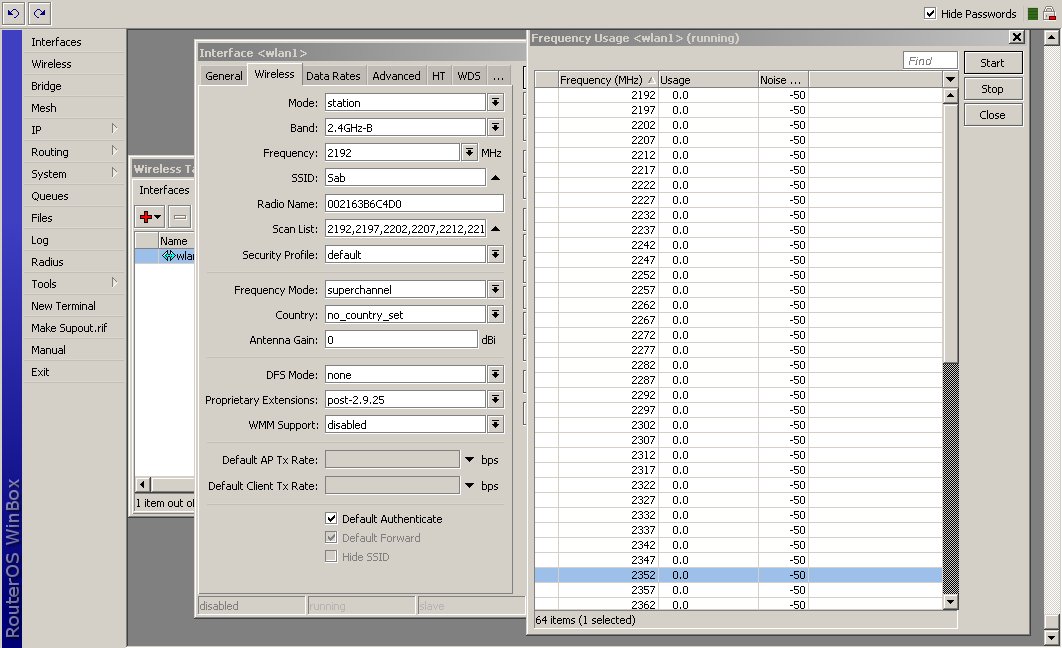

Tried with mini-pci express wireless card and it is working fine in 2.4ghz mode. It is an Atheros XB91 reference design based card.
AR928X (AR5BHB92/AR5009)..miniPCIe
AR5008E-3NX(AR5BXB72) miniPCIe
don’t work in 4.04b. i dont have other card for test.
and when you just use Scan do you see other networks?
no
you can check your router now - it should be working as we placed a fix there.
I’ve make test fixed 4.04 with 4.03( the same cards). From 4.03 to 4.04 data transfer with normal rate, from 4.04 to 4.03 data transfer with rate 10-50 kb. Signal quality show 95-98% in two way. With nstream don’t working- every time disconnect- data lost. So if you will place fix to other router you will test it together. See mail.
ok.. its fixed. stay some problem with frame police.
