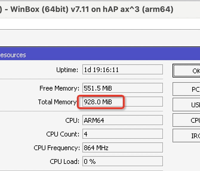

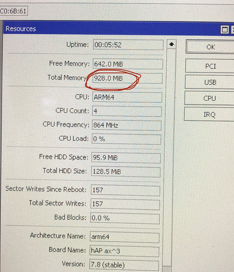

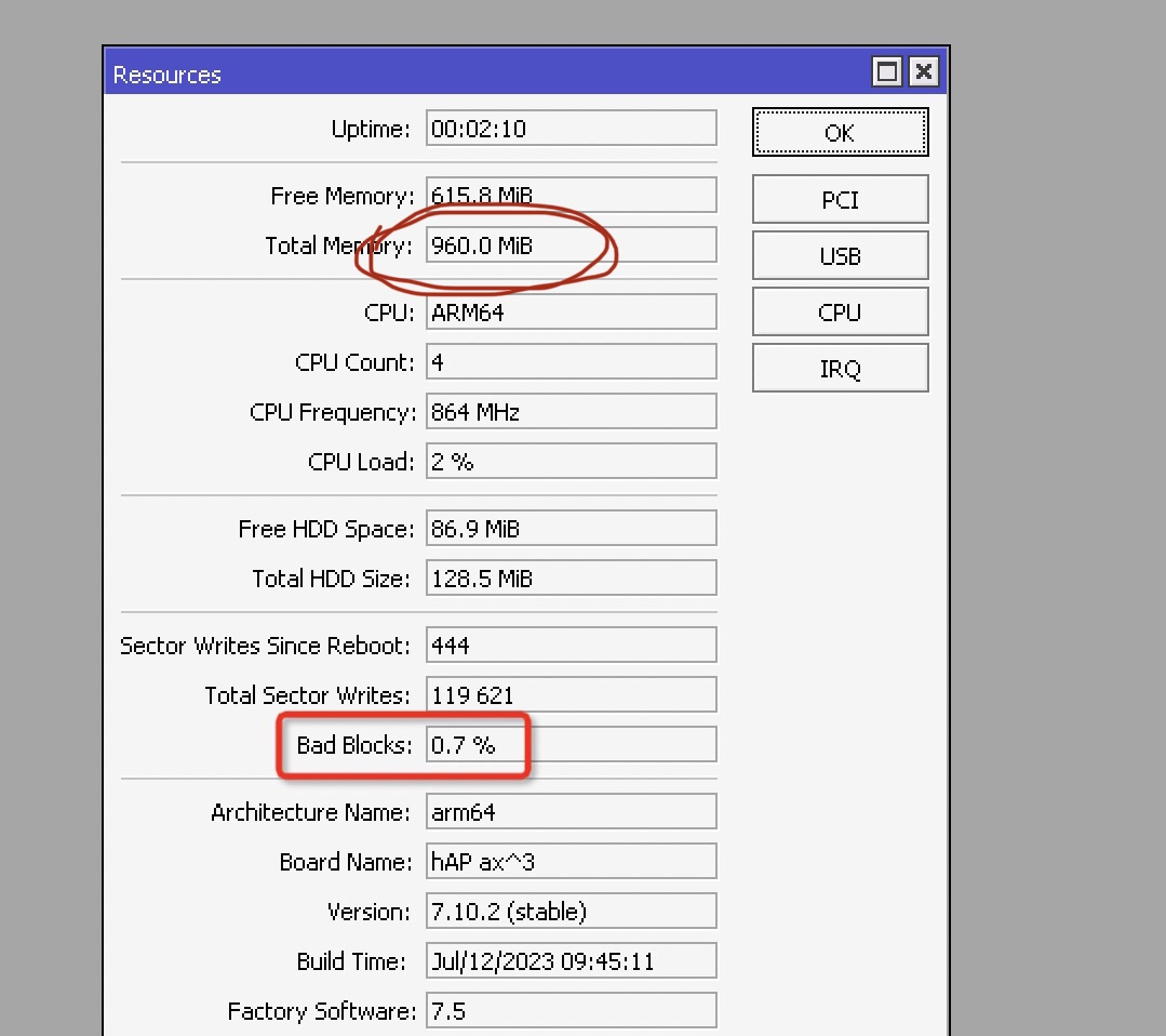

one is 928mb, and the other one is 960mb, wondering why there is such a difference?
And what is your ax3’s RAM size? please post reply,

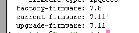

Did you also upgrade routerboot firmware on both devices? (execute /system/routerboot/upgrade and reboot device).
yes no changes
Agree, it’s odd that two identical units have 32MB difference. While I suspect this isn’t going to be an issue, I don’t like oddities like this myself…
I take it config is default and no other packages are installed? Basically is config also identical? Certainly different feature being enabled use memory differently…
There was probably a faulty RAM chip at manufacturing so they disabled it rather than throw the whole package away. It’s possibly even something that’s detected on a startup memory test but usually that’s in the realm of ECC memory. I wouldn’t worry about it, 32mb isn’t going to make a big difference in usability.
Yes the settings are the same ![]()
Well, good news is ECC is doing it thing. The rather exact 32MB difference also points in that direction too.
But I asked about config since if was hardware … not a lot you can do except return or accept the marginal difference
