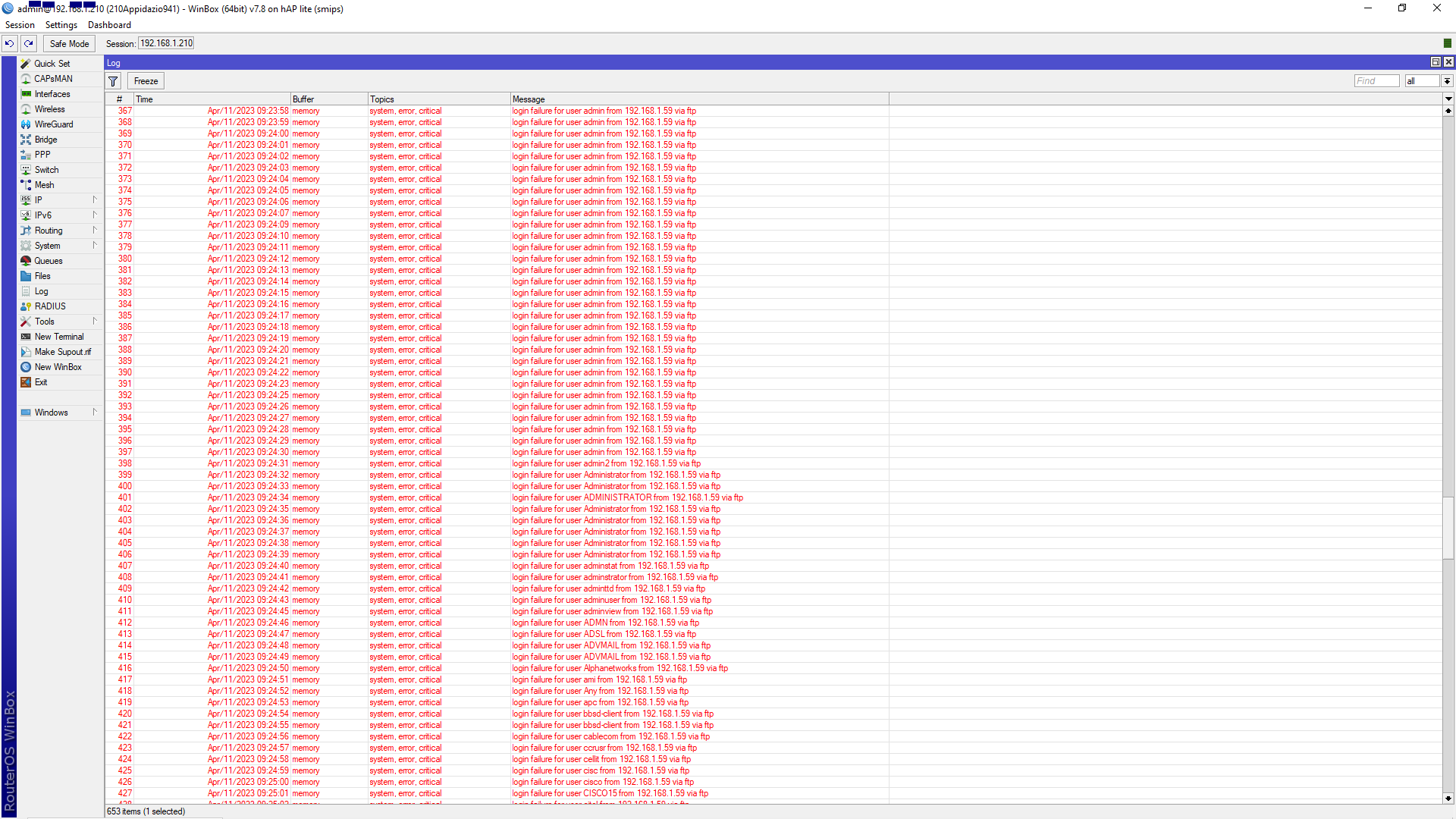

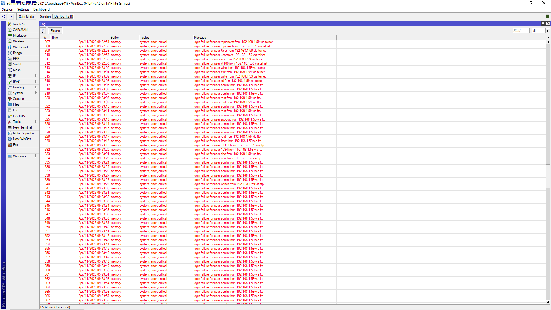

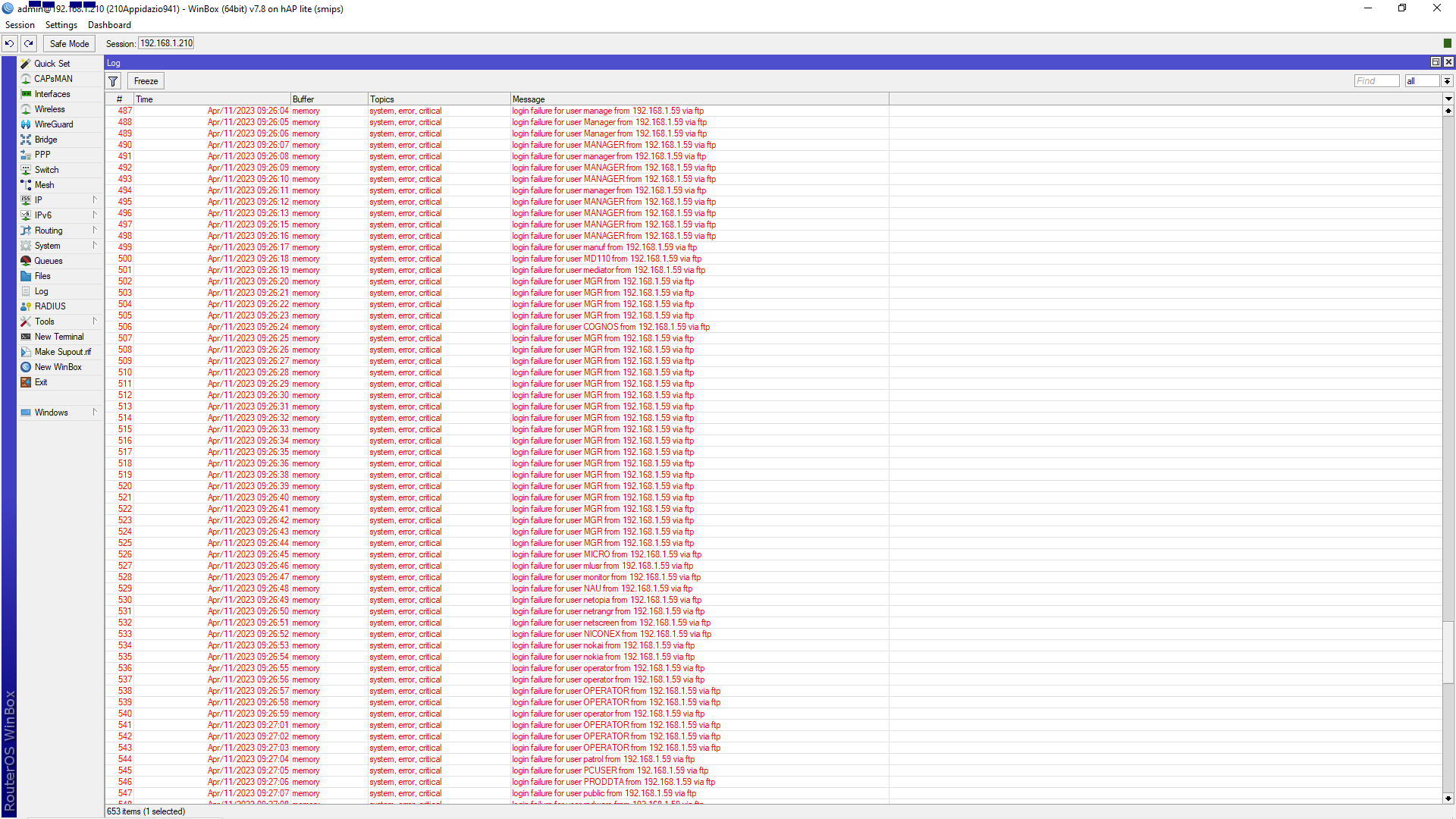

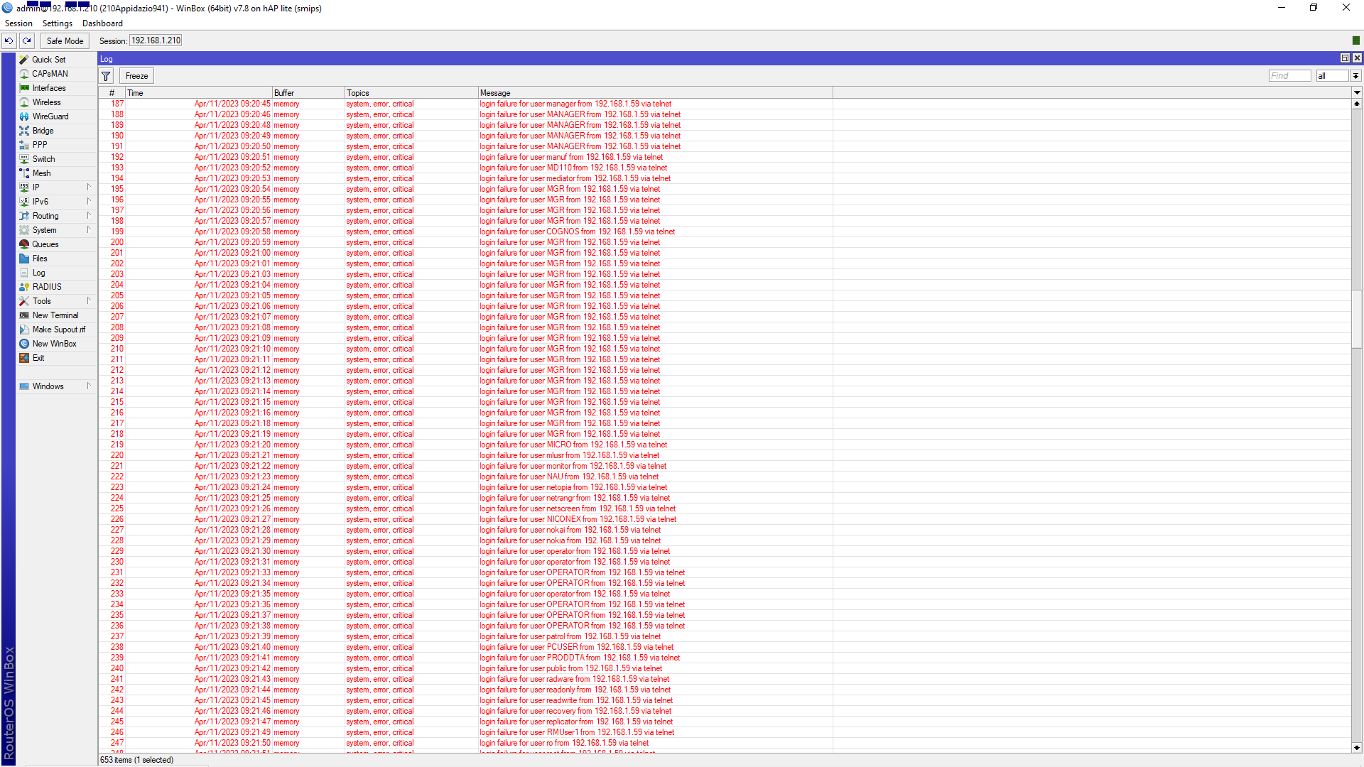

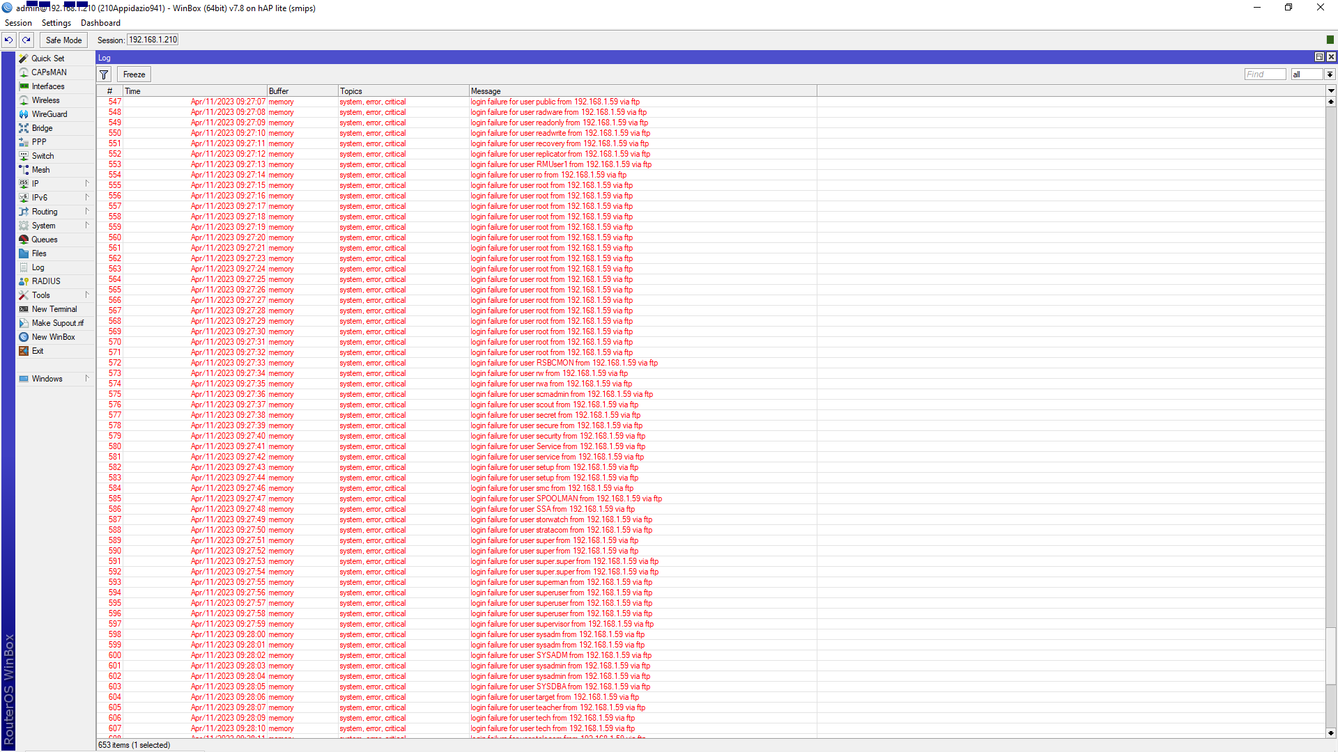

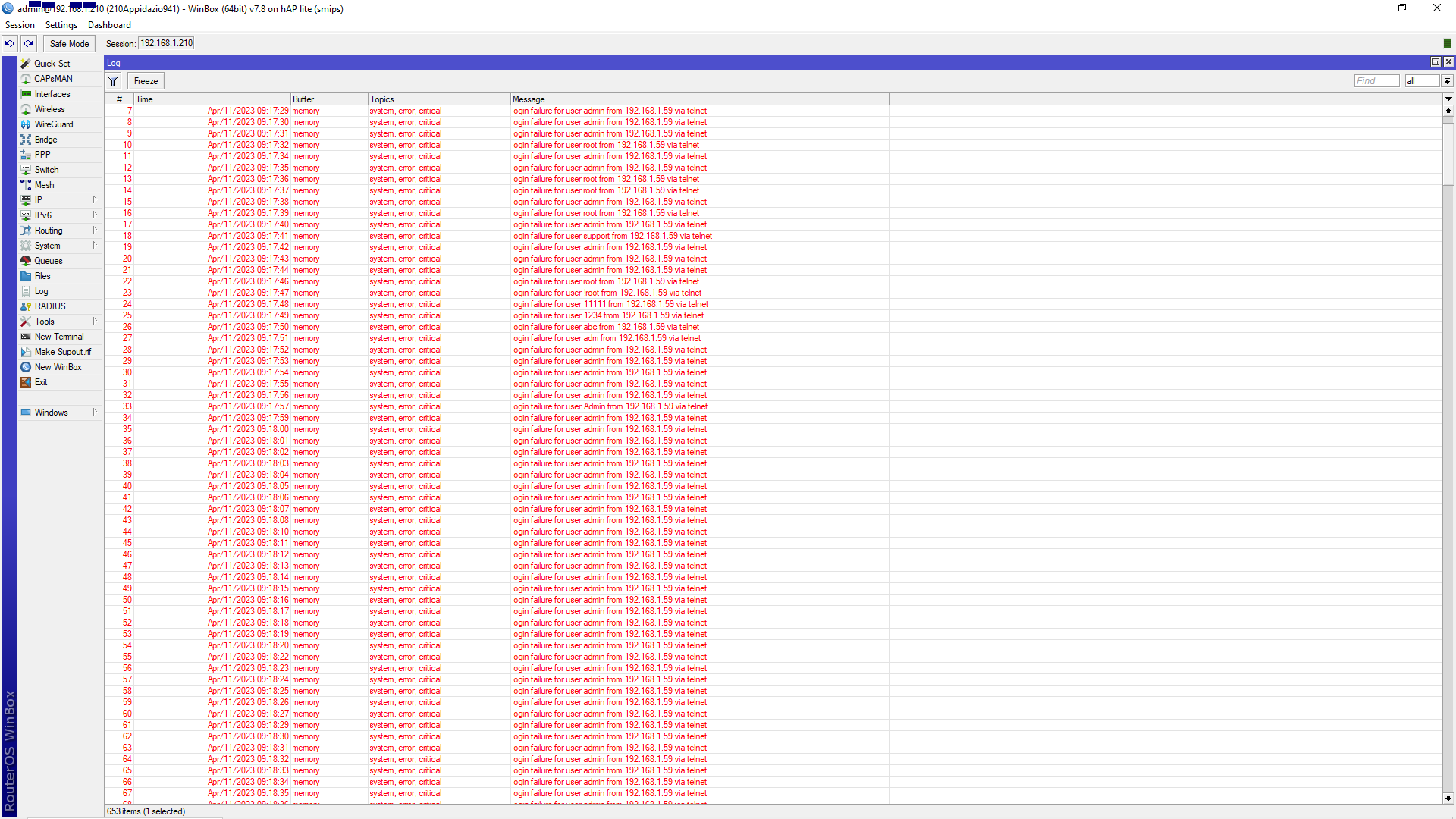

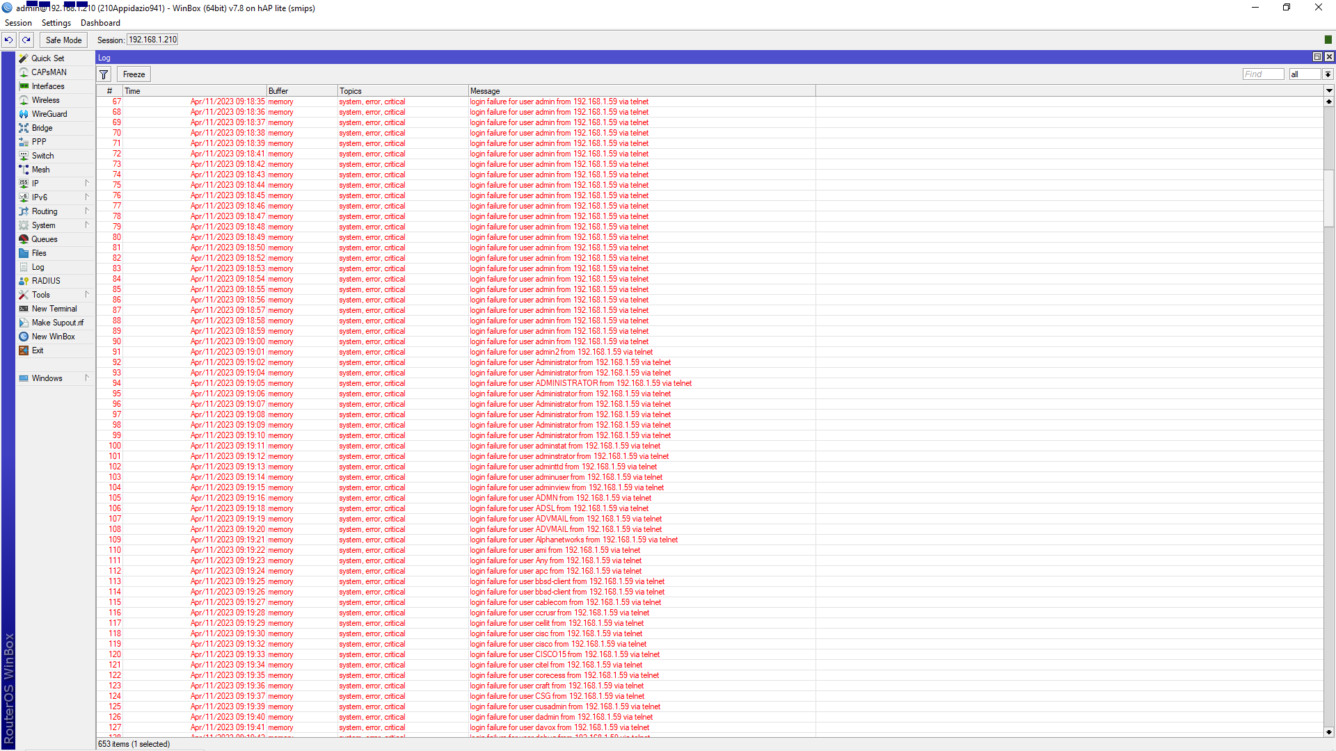

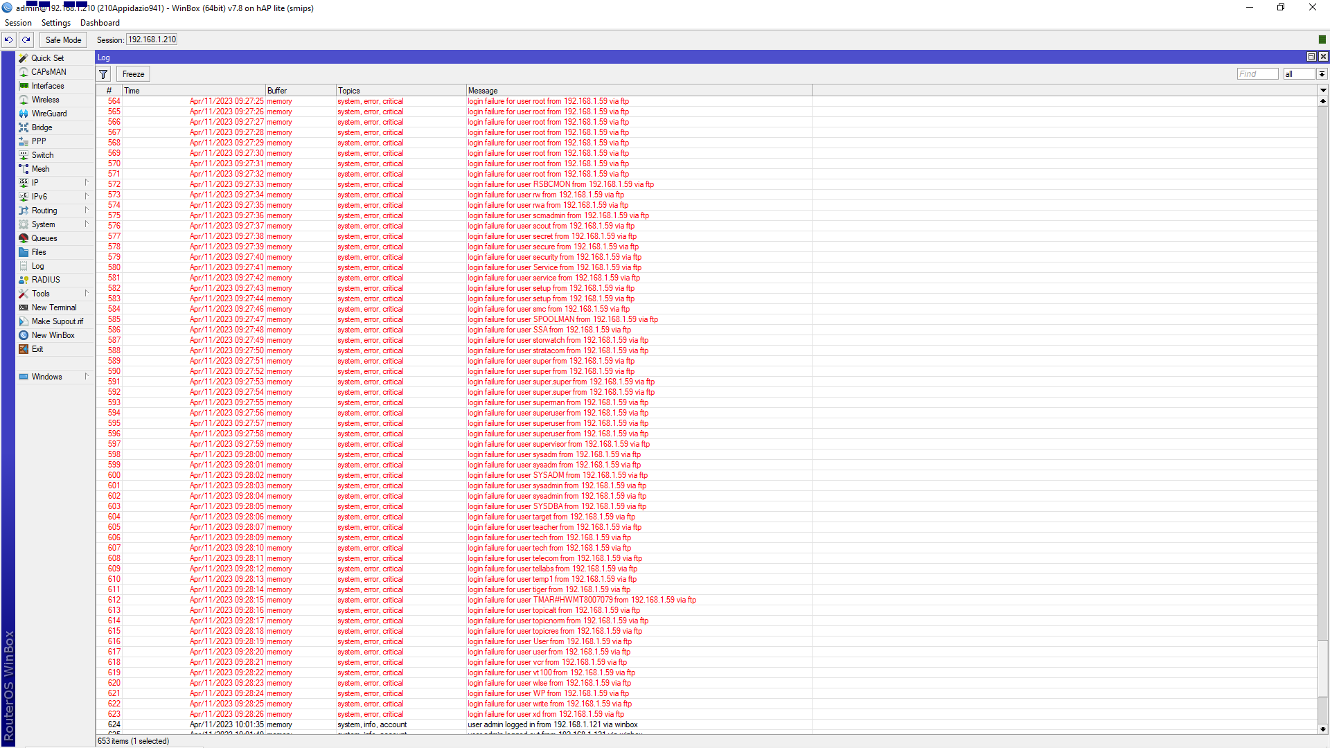

I have a script that monitors failed logins, and I was informed automatically
20:32:54 - login failure for user admin from 192.168.0.46 via ssh;
20:32:55 - login failure for user admin from 192.168.0.46 via ssh;
20:32:56 - login failure for user admin from 192.168.0.46 via ssh;
20:32:57 - login failure for user dircreate from 192.168.0.46 via ssh;
20:32:58 - login failure for user MikroTikSystem from 192.168.0.46 via ssh;
20:32:59 - login failure for user EServicios from 192.168.0.46 via ssh;
20:33:00 - login failure for user from 192.168.0.46 via ssh;
20:33:01 - login failure for user SolucTec from 192.168.0.46 via ssh;
20:33:02 - login failure for user admin from 192.168.0.46 via ssh;
20:33:03 - login failure for user root from 192.168.0.46 via ssh;
20:33:04 - login failure for user sysadm from 192.168.0.46 via ssh;
20:33:05 - login failure for user user from 192.168.0.46 via ssh;
20:33:06 - login failure for user admin from 192.168.0.46 via ssh;
20:33:07 - login failure for user from 192.168.0.46 via ssh;
20:33:08 - login failure for user admin from 192.168.0.46 via ssh;
20:33:10 - login failure for user Admin from 192.168.0.46 via ssh;
20:33:10 - login failure for user root from 192.168.0.46 via ssh;
20:33:11 - login failure for user admin from 192.168.0.46 via ssh;
20:33:12 - login failure for user guest from 192.168.0.46 via ssh;
20:33:14 - login failure for user Administrator from 192.168.0.46 via ssh;
20:33:14 - login failure for user root from 192.168.0.46 via ssh;
20:33:15 - login failure for user meo from 192.168.0.46 via ssh;
20:33:16 - login failure for user Admin from 192.168.0.46 via ssh;
20:33:17 - login failure for user admin from 192.168.0.46 via ssh;
20:33:18 - login failure for user ubnt from 192.168.0.46 via ssh;
20:33:20 - login failure for user root from 192.168.0.46 via ssh;
20:33:21 - login failure for user admin from 192.168.0.46 via ssh;
20:33:22 - login failure for user vodafone from 192.168.0.46 via ssh;
20:33:23 - login failure for user admin from 192.168.0.46 via ssh;
20:33:24 - login failure for user Administrator from 192.168.0.46 via ssh;
20:33:25 - login failure for user root from 192.168.0.46 via ssh;
20:33:26 - login failure for user Admin from 192.168.0.46 via ssh;
20:33:29 - login failure for user from 192.168.0.46 via telnet;
20:33:30 - login failure for user admin from 192.168.0.46 via telnet;
20:33:31 - login failure for user admin from 192.168.0.46 via telnet;
20:33:38 - login failure for user admin from 192.168.0.46 via ftp;
20:33:39 - login failure for user admin from 192.168.0.46 via ftp;
20:33:40 - login failure for user admin from 192.168.0.46 via ftp;
20:33:41 - login failure for user dircreate from 192.168.0.46 via ftp;
20:33:42 - login failure for user MikroTikSystem from 192.168.0.46 via ftp;
20:33:43 - login failure for user EServicios from 192.168.0.46 via ftp;
20:33:44 - login failure for user SolucTec from 192.168.0.46 via ftp;
20:33:45 - login failure for user admin from 192.168.0.46 via ftp;
20:33:46 - login failure for user root from 192.168.0.46 via ftp;
20:33:47 - login failure for user sysadm from 192.168.0.46 via ftp;
20:33:48 - login failure for user user from 192.168.0.46 via ftp;
20:33:49 - login failure for user admin from 192.168.0.46 via ftp;
20:33:50 - login failure for user admin from 192.168.0.46 via ftp;
20:33:51 - login failure for user Admin from 192.168.0.46 via ftp;
20:33:52 - login failure for user root from 192.168.0.46 via ftp;
20:33:53 - login failure for user admin from 192.168.0.46 via ftp;
20:33:54 - login failure for user guest from 192.168.0.46 via ftp;
20:33:55 - login failure for user Administrator from 192.168.0.46 via ftp;
20:33:56 - login failure for user root from 192.168.0.46 via ftp;
20:33:57 - login failure for user meo from 192.168.0.46 via ftp;
20:33:58 - login failure for user Admin from 192.168.0.46 via ftp;
20:33:59 - login failure for user admin from 192.168.0.46 via ftp;
20:34:00 - login failure for user ubnt from 192.168.0.46 via ftp;
20:34:01 - login failure for user root from 192.168.0.46 via ftp;
20:34:02 - login failure for user admin from 192.168.0.46 via ftp;
20:34:03 - login failure for user vodafone from 192.168.0.46 via ftp;
20:34:04 - login failure for user admin from 192.168.0.46 via ftp;
20:34:05 - login failure for user Administrator from 192.168.0.46 via ftp;
20:34:06 - login failure for user root from 192.168.0.46 via ftp;
20:34:08 - login failure for user Admin from 192.168.0.46 via ftp;
20:34:09 - login failure for user admim from 192.168.0.46 via ftp;
20:34:10 - login failure for user webadmin from 192.168.0.46 via ftp;
20:34:11 - login failure for user tech from 192.168.0.46 via ftp;
20:34:12 - login failure for user administrator from 192.168.0.46 via ftp;
20:34:13 - login failure for user manager from 192.168.0.46 via ftp;
20:34:14 - login failure for user root from 192.168.0.46 via ftp;
20:34:15 - login failure for user sysadmin from 192.168.0.46 via ftp;
20:34:16 - login failure for user login from 192.168.0.46 via ftp;
20:34:17 - login failure for user guest from 192.168.0.46 via ftp;
20:34:18 - login failure for user admin2 from 192.168.0.46 via ftp;
20:34:19 - login failure for user user from 192.168.0.46 via ftp;
20:34:20 - login failure for user root from 192.168.0.46 via ftp;
20:34:22 - login failure for user root from 192.168.0.46 via ftp;
20:34:23 - login failure for user support from 192.168.0.46 via ftp;
20:34:24 - login failure for user root from 192.168.0.46 via ftp;
20:34:25 - login failure for user admin from 192.168.0.46 via ftp;
20:34:26 - login failure for user admin from 192.168.0.46 via ftp;
20:34:27 - login failure for user HPSupport from 192.168.0.46 via ftp;
20:34:28 - login failure for user root from 192.168.0.46 via ftp;
20:34:29 - login failure for user root from 192.168.0.46 via ftp;
20:34:30 - login failure for user admin from 192.168.0.46 via ftp;
20:34:31 - login failure for user login from 192.168.0.46 via ftp;
20:34:32 - login failure for user admin from 192.168.0.46 via ftp;
20:34:33 - login failure for user guest from 192.168.0.46 via ftp;
20:34:35 - login failure for user root from 192.168.0.46 via ftp;
20:34:36 - login failure for user admin from 192.168.0.46 via ftp;
20:34:37 - login failure for user root from 192.168.0.46 via ftp;
20:34:38 - login failure for user admin from 192.168.0.46 via ftp;
20:40:30 - login failure for user admin from 192.168.0.46 via web;
20:41:14 - login failure for user from 192.168.0.46 via telnet;
20:41:15 - login failure for user admin from 192.168.0.46 via telnet;
20:41:16 - login failure for user admin from 192.168.0.46 via telnet;
20:41:25 - login failure for user admin from 192.168.0.46 via ftp;
20:41:27 - login failure for user admin from 192.168.0.46 via ftp;
20:41:28 - login failure for user admin from 192.168.0.46 via ftp;
20:41:29 - login failure for user dircreate from 192.168.0.46 via ftp;
20:41:30 - login failure for user MikroTikSystem from 192.168.0.46 via ftp;

I post the screenshots of only one device but it does it with all those in the LAN. I also realized that it was the PCs inside the LAN that did it but up until now I’ve always thought they were controlled by an external hacker.
Basically maybe it’s really like this because it’s absurd that an antivirus should do these things without asking for permission.
It seems to me something done on purpose for malice and commercial competition against MT who are the best and in any case could take some measures in the new FW.
In total, hacker or no hacker, essentially I have found myself in problems in the last few weeks with three newly bought 9-port RBs of which 2 are unreachable (http://forum.mikrotik.com/t/routerboard-unreachable-after-enabling-protected-routerboot/166716/1) and I hope to save the third by reinstalling the operating system with Netinstall (if it goes successful)…
