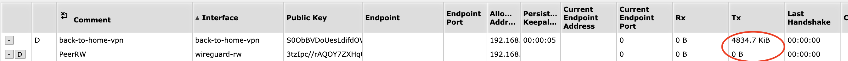

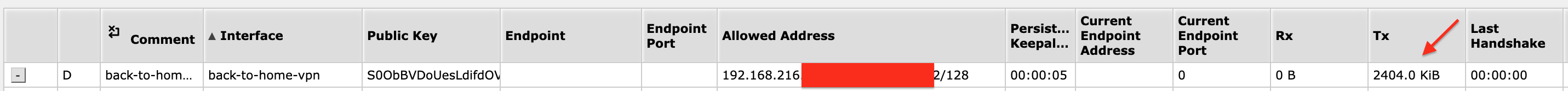

Is it normal that my BTH interface is always transmitting (but not receiving) packets, even if no client is connected to it?
Take a look to this:

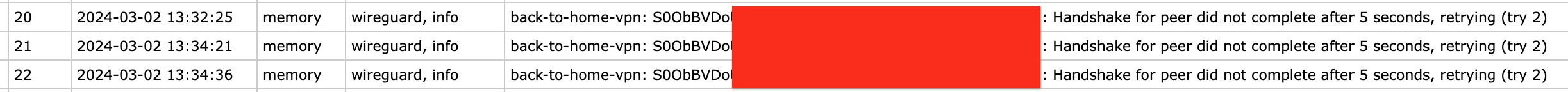

On the other hand (or maybe related to the above question), lots of messages like this appears in my log:

There appears to be a problem with the latest version 7.14 with excessive logging AND/OR handshake attempts.
Suggest wait for 7.14.1 :slight_smile: or go back to 7.13.5
Re: transmitting
Wireguard always tries to transmit if interface is active. Only when something comes back, you know it works.
Logging
That’s definitely a bug in my book.
Well, I have configured also a road-warrior peer and no transmission is shown when the client is not connected:
